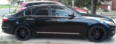

After owning my 2009 4.6L Sedan for a few months, I decided I wanted to go for some aftermarket rims. I used tirerack.com to show me wheels that would 'fit', and after much study (including research of other wheel threads here) I ordered a set of 18x8" Advanti Denaro Wheels, offset +42, black with machined lip. They were shipped in, mounted, and then driven out into the parking lot... for about 10 seconds... before they drove it right back into the bay, and right back onto the lift. One (not both) of the front wheels was rubbing on the brake caliper (and scraping off the new paint that I had spent the weekend working on :mad: ). I understand that this is a common problem with these Brembo?? calipers.
As it turned out, it worked for the best, because once the wheels were on the car, I instantly thought that I didn't like the look. (Also, when they put the originals back on, I thought to myself how really good they look, and why am I going to all this trouble/expense...)

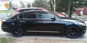

Varrstoen ES 2.2.1 - Here is a quick photoshopped attempt at the look.
If I were to go this way, the wheel is available in 18 x 8.5" with offsets of either +35 or +45 (also 15 and 25). I can't get www.aspecwheels.net (the only American dealer I can find) to guarantee fittment (sp?) so I was wondering what any of you thought here.
