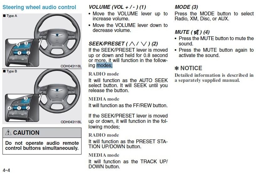

Are you sure you aren't accidently hitting the MODE changer on the steering wheel and it is changing modes? I have don't this a few times while turning and the radio goes from FM to another mode. I found that it was actually me hitting the MODE changer on the steering wheel. Just a thought.
Absolutely sure I am not hitting anything. This has now occurred about 10 times since Jan 1. Only once has the radio stayed on XM when starting the car.... Wait about 20 seconds and it clicks over to FM or AM by itself. Since multiple people are having issue, this is more than likely software and hardware.
However once you change it back to XM it stays until the next time you start the car. Hopefully a software update will fix.
There is no way to hit the button accidentally. There is problem in the system and started after Jan 1.
