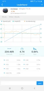

Here is the best I could do tonight. All stock.
According to your acceleration graph, it looks like your shifts are fantastic. You did a really good job. Nice.
How exactly did you do this run? Were you manually shifting?
Man, honestly... I don't even remember.. lol.. I was just so excited to get the dragy working.. I did like multiple runs, doing different things, full auto, some manual, a combination of both.
Next time I will keep better track of what I'm doing. I'm just happy I got under 5 seconds.
Also, can you explain the acceleration graph? I don't know what it means.

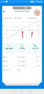

So, generally speaking, the acceleration portion of the graph (yellow line) represents how hard your car is pulling. The higher the line relative to the 0.0 horizontal line, the faster you are accelerating. With this you can easily see gear changes and how hard your car is launching.
Here is a graph where my shifts were horrible...
The red arrows point to 1-2 shift and 2-3 shift, can you see the huge dip in the yellow line, especially in the 1-2 gear change? I'm not seeing those huge dips in your graph, this, you had good shifts I think.

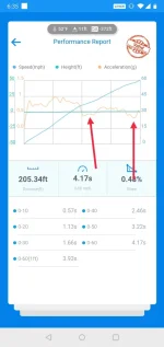

Now compare my above graph to my fastest run, and notice how the gear changes are quicker and don't result in as big/long of dips on the graph...
Much quicker shifts here, resulting in my faster time, even though my acceleration curve still peaked at 1g in both graphs (ie was still making the same power).
Hope this makes sense.

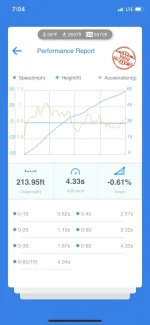

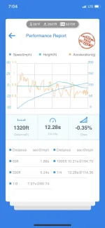

Okay so these are my best two passes from the night. I broke into the 1.7 60 foot with a 1.79. But it was late and the car was pretty well heat soaked so I lost power top end so I’m confident if I can replicate that I’ll have a 12.1 on my hands and also I set by far my best 0-60
