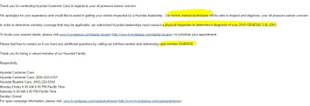

I have been driving the car since the sensor popped up. Now I'm so used to it, It shows & disappear in few mins. I'm very disappointed how Hyundai America is distinguishing Korean gen & US gen. This will be my last Hyundai too.

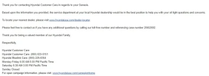

Here is the reply, I got from the Hyundai Customer service.
