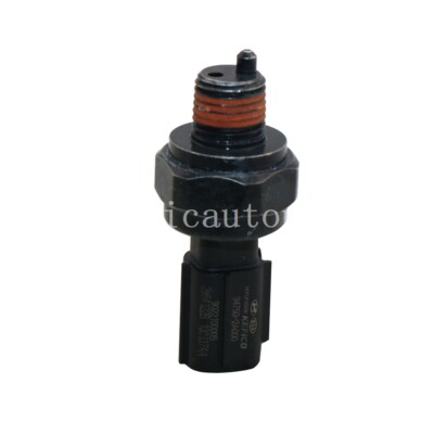

You've mentioned the part as $50 a couple of times. Where did you get that price from. It would be worthwhile to know, because the cheapest I've found the oil pressure sensor for is $115, with $154 being the normal dealer price.
you can search online: here is the part # 94750-2A0000 & yes, dealer prices are $115 up to $160.

My oil light also comes on intermittently as of this winter. It'll cut off when engine is revved above 750, or if I cut the vehicle off and wait a bit. My dealer quoted me $1.4k in labor and about $1k to $1.3k in parts (most of the cost due to replacing rings, gaskets, and spark plugs while you're already in the area). The oil switch/sensor is located inside of the top of the engine as everyone else has stated.

This is normal when your oil pressure switch”sensor” brake down then genesis act this way happened with me too. Either get that sensor changed or check oil level before every start in the morning.
