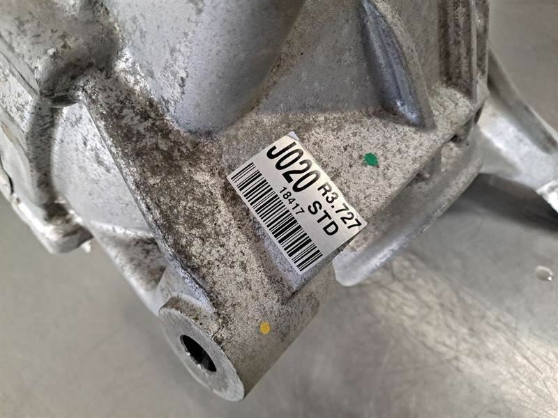

But yes, I'm also disappointed it doesn't have double wishbone up front too. By the way, does anybody know if my 2023 G70 2.0T Sport Prestige has LSD? The window sticker doesn't say anything, but the owner's manual lists BOTH options (open and LSD) for the 2.0T, and I have the top line trim. I don't think so, but wanted to ask. And if there's a way to know if I back up the car on my ramps, like on a label or something (before it falls off. Ha ha). Just got the car yesterday. Thank you.
AFAIK, only 2.0T G70s that came with LSD is the 6MT as part of the Sport package. That said, it isn't impossible to rectify an open diff... ebay is your friend. ;)
Only problem is, lots of Stinger and G70 owners without LSD are looking to do the same, which has bid up prices of used LSDs to be almost as much as what you can buy a brand new one directly from Korea, which is also available on ebay.
What most don't know is that the G70 6MT LSD is exactly the same as the LSD for the 3.3T. Same final drive ratio. I snatched this one for the Stinger, at far lower price than the going rate for 3.3T ones. They don't come up very often, since there aren't that many G70 6MTs around. Patience pays off. :)

Thank you, but I don't want to mess with my brand new car; at least not now. Ha ha. Just want to know what I have, since I'd have to change the fluid much sooner if it's an LSD, due to the extra crap the clutch discs spew. What is weird is my 2023 owner's manual mentioning LSD on the 2.0T, when 6MTs are no longer made (since 2022). So some 2.0Ts must have LSDs, but maybe in other markets.
Is there a way to know what I have (open or LSD) from somewhere down there, either stamped, or a label? I'd need details of the code, initials, etc., stamped on the diff. Thx.
I would start by looking at the silver label. LSD will look like the one pictured above. Open diff should look like this:
A quick burnout (with traction control turned off) should tell you. Add a little sand or water if you have trouble breaking them loose.
Okay, just looked everywhere under my car (no need to lift it, surprisingly), and there's no label anywhere. Only an etched part number: KL2REI1121-W, along with a QR code I'm sure cannot be read (ha ha). The good news I found is there are both a drain and fill plugs, so nice. Plan to change the fluid maybe at the 2nd or 3rd oil change (so 6K or 11K miles, since I'll do the first at 1K or so), to remove all the assembly crap from there. Need to check which fluid it uses, and how much. Cheap insurance IMO.
