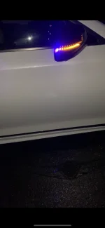

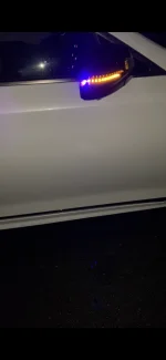

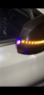

2018 G80 Sport - In the process of replacing the passenger side view mirror because one of the diodes in the mirror was “burnt out” or something I’m not sure other than it was purple. (See images). The dealer is going to replace the entire mirror (Under warranty) which I’m completely fine with but during this process, they ordered the mirror and realized it wasn’t painted. Then sent the mirror off for paint but painted it the color of the car (Casablanca White) based off the VIN not realizing that the Sport models have black mirrors. Also claiming they do not know the color code for the mirror because it’s not attached to the VIN??? So a body shop representative had to physically go to dealer look at the car and confirm/find out what the color should be. I haven’t had my car in weeks and won’t until the beginning of the year, very frustrating. So the final questions:
1. Has anyone ever seen this “burnt out” diode before
2. What is the paint color code for the side view mirrors on 2018 Sports

I don't know if it was me, I'd press the dealer to get it right and fix it under warranty, like they should. It shouldn't be your burden to figure it out.
