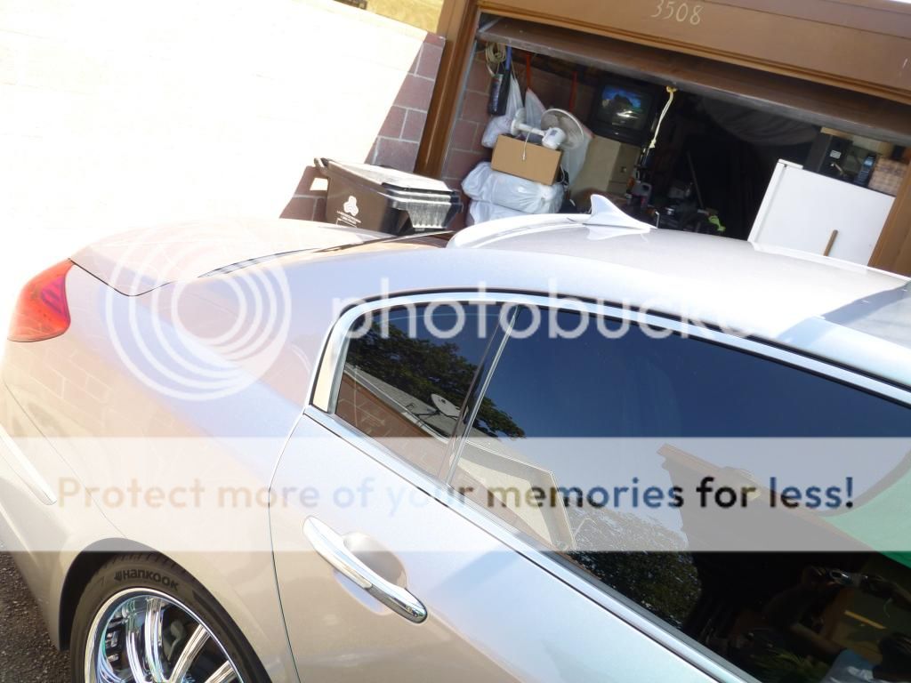

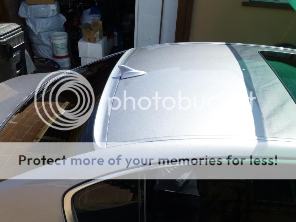

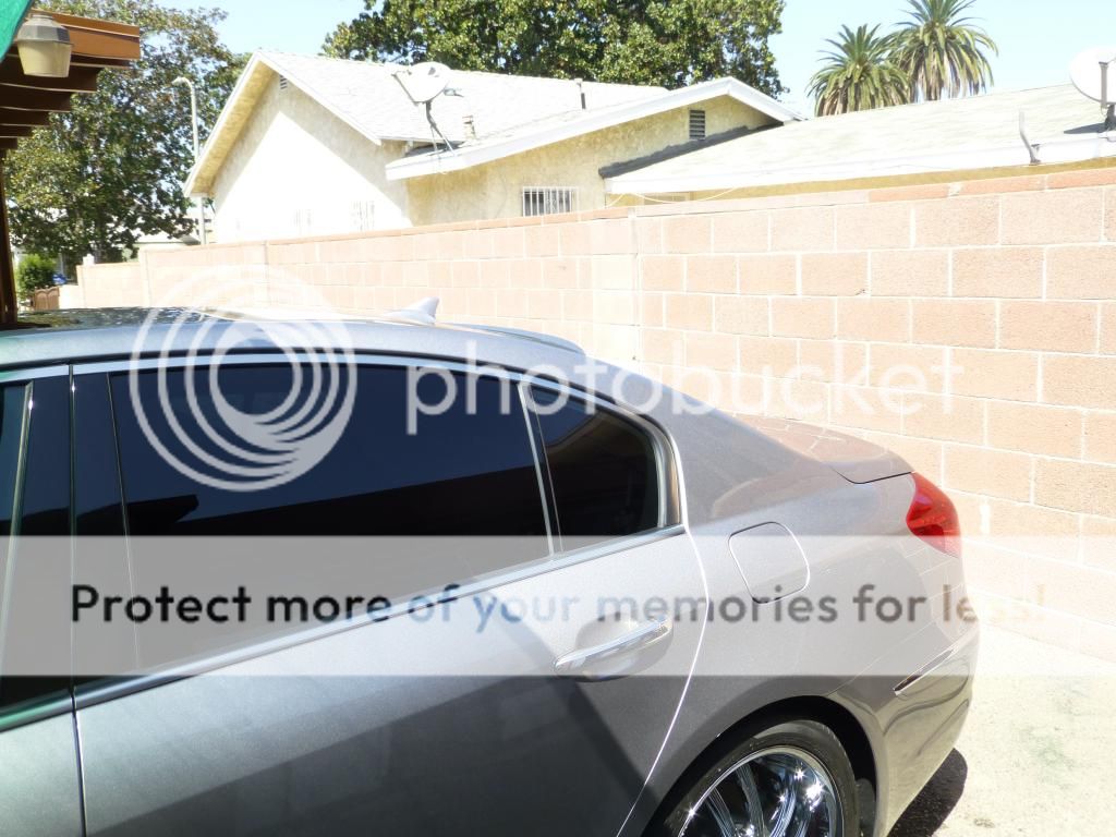

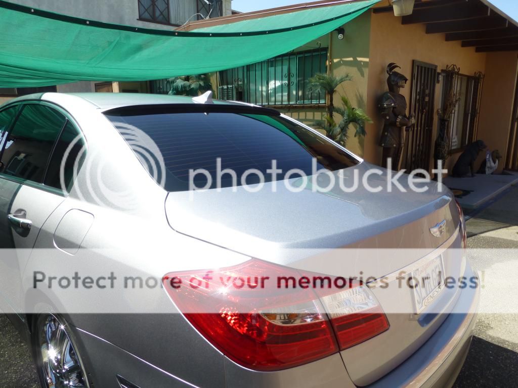

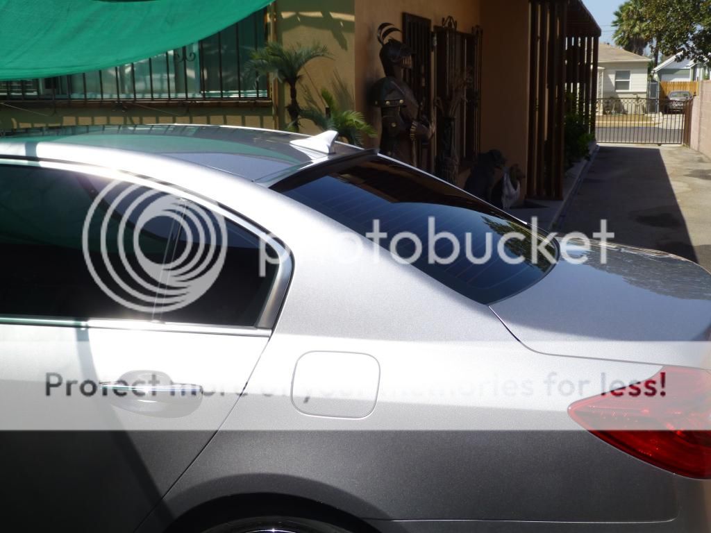

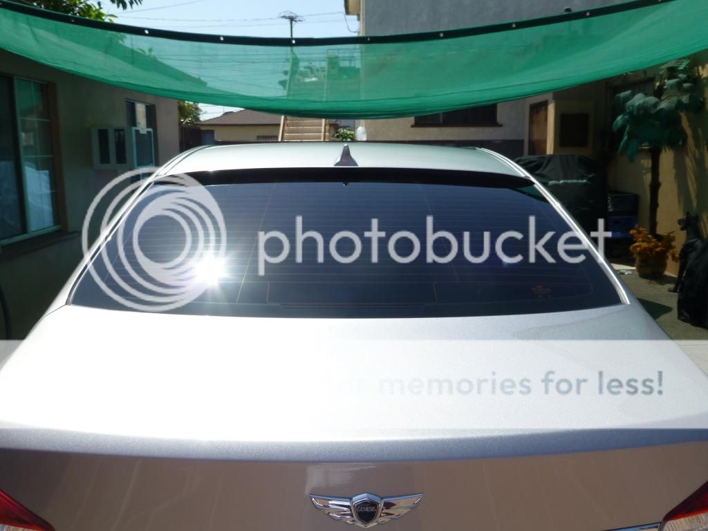

Love the look of a rear window spoiler along with a trunk lid spoiler so did the install on my Sonata and added the window spoiler to my Coupe and now have done the window spoiler for the Sedan with the trunk spoiler to come.
This spoiler came unprimed and unpainted so had to prime and paint. It's very "heavy" and flexible; kind of like a bar of rubber. Paint supplies came from Automotive TouchUp Paint, the same company I got the paint supplies from to paint the Prodigy lip for my Coupe.
Unlike the spoiler for the Coupe, this spoiler simply adheres to the rear window and window seal via 3M double sided tape, so installation is very easy. Here's pics, enjoy!

Thank you 61Espo! Unlike most rear window spoilers, this one is very "sturdy". It's basically a solid hunk of rubber formed and "cut" into the shape you see. It's pretty heavy, as well as being very flexible, so when you paint it (or have it painted), you have to make sure the paint will "flex" with the spoiler while you're installing it; otherwise you'll get "cracks" in the paint.
Also you almost have to sit on it to "seal" it to the rear window; this is because the double-sided tape it comes with, in my opinion, doesn't really stick that good. But the good thing, if it comes loose, you can get some 3-M 20lb double sided to put it back on. ;) Other than that, it's a pretty simple install; the "hard" part is the painting. If you and Videopho can't make a connection, here's the information for where I purchased mine: http://www.ebay.com/itm/Rear-Roof-S...3-4dr-sedan-/360674582623?hash=item53f9e1605f
