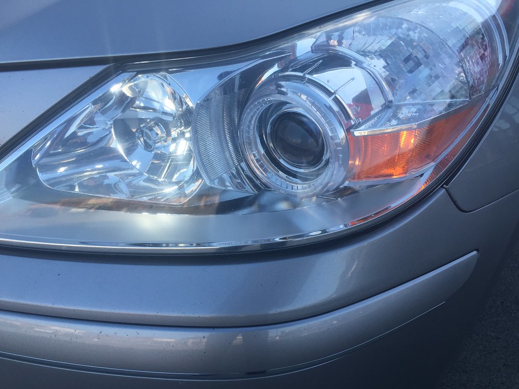

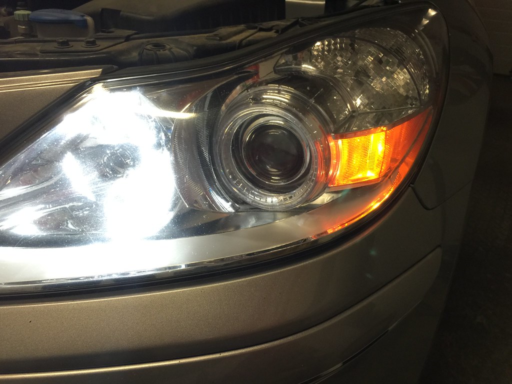

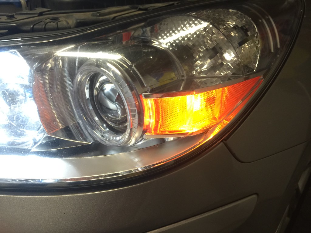

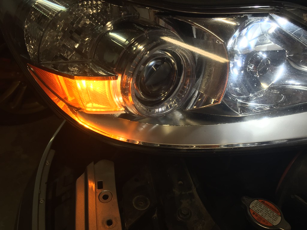

Hi guys, there hasn't been any write-ups on the replacement of the sidemarker bulbs.
Mine died (Pics below):

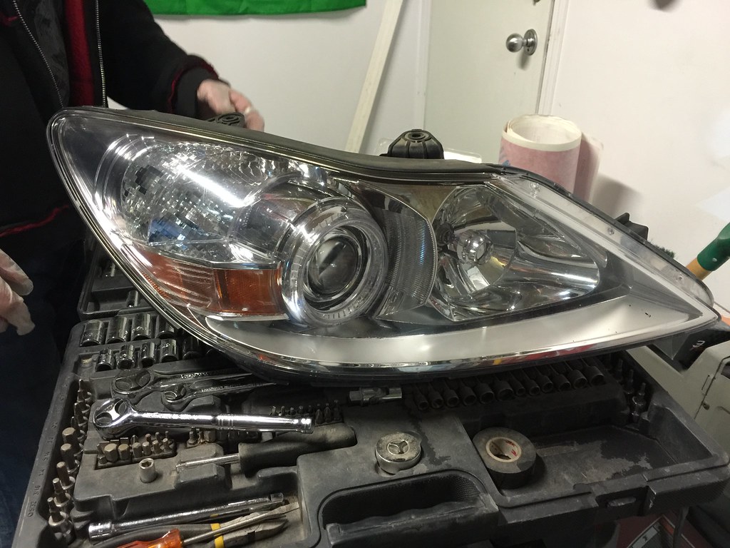

They are impossible to replace unless the headlights are removed. Tried removing the headlights without the bumper off but this looks like a bumper removal job (Takes 5 minutes).
Headlight removed:
Rear shot of Headlight

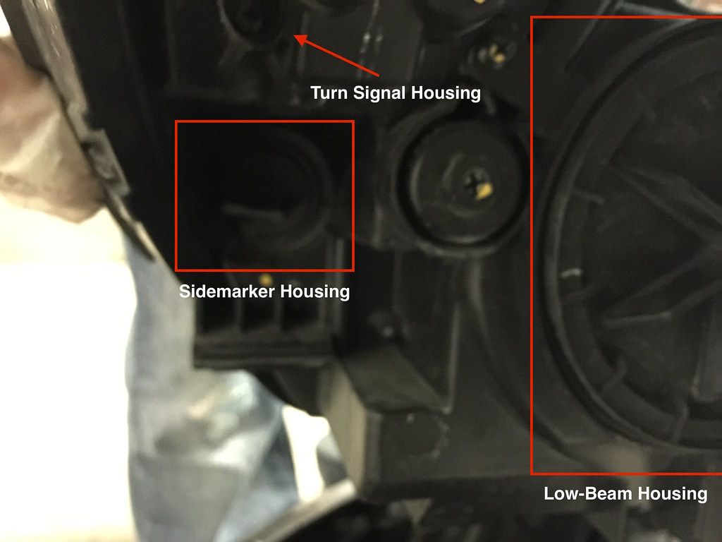

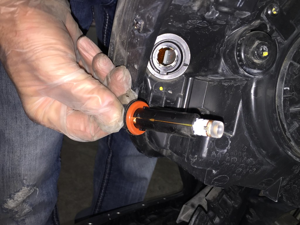

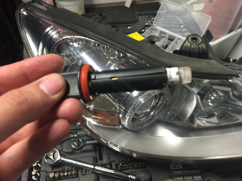

Sidemarker Bulb Housing (194 Bulbs)
Passenger Side
Driver Side

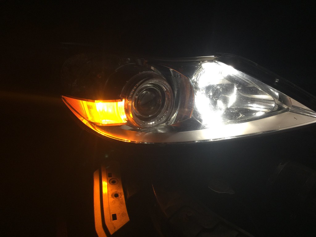

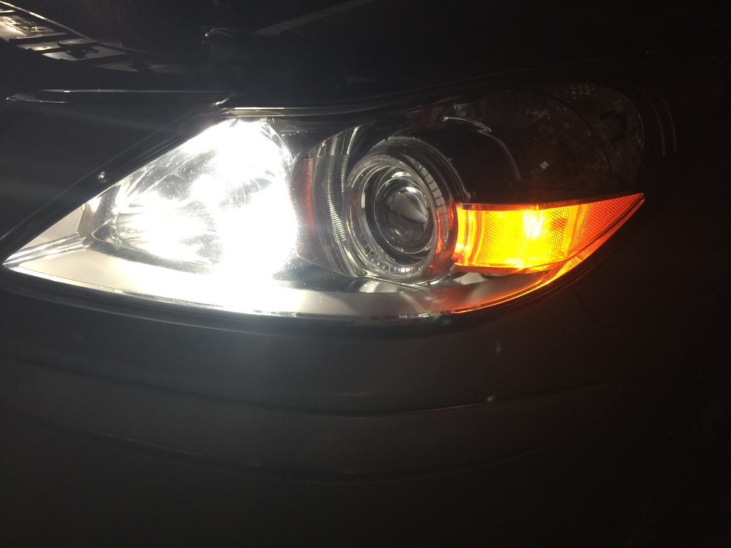

BEFORE
AFTER

The originals are the 194 socket wedge bulbs that are found in the sidelight, floor light and the courtesy lights.
Yes, I replaced them with LEDs.
The colour won't matter due to the reflector.
I've never done an oil change in my life and I was able to remove the bumper.
Will post bumper removal instructions tomorrow.

Straight replacement. Plug it in and test it. If it does not light up, flip the bulb over and try again. It will work. LEDs will not work if the +/- are not correct. It will not damage the bulbs. However, with conventional bulbs, either way works.

I've had some spare 194 bulbs from Diode Dynamics.
I have the HP5's (http://www.diodedynamics.com/store/2009-2013-hyundai-genesis-sedan-sidemarker-leds-pair#!prettyPhoto).
