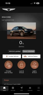

I'm noticing today that suddenly my Genesis Connected Services app is incorrectly showing my vehicle at 0% charge when I am actually at 59%. Pulling down to refresh the screen doesn't change it. Is anybody else seeing this in their app?
UPDATE: restarting the app worked (>.< duh)
