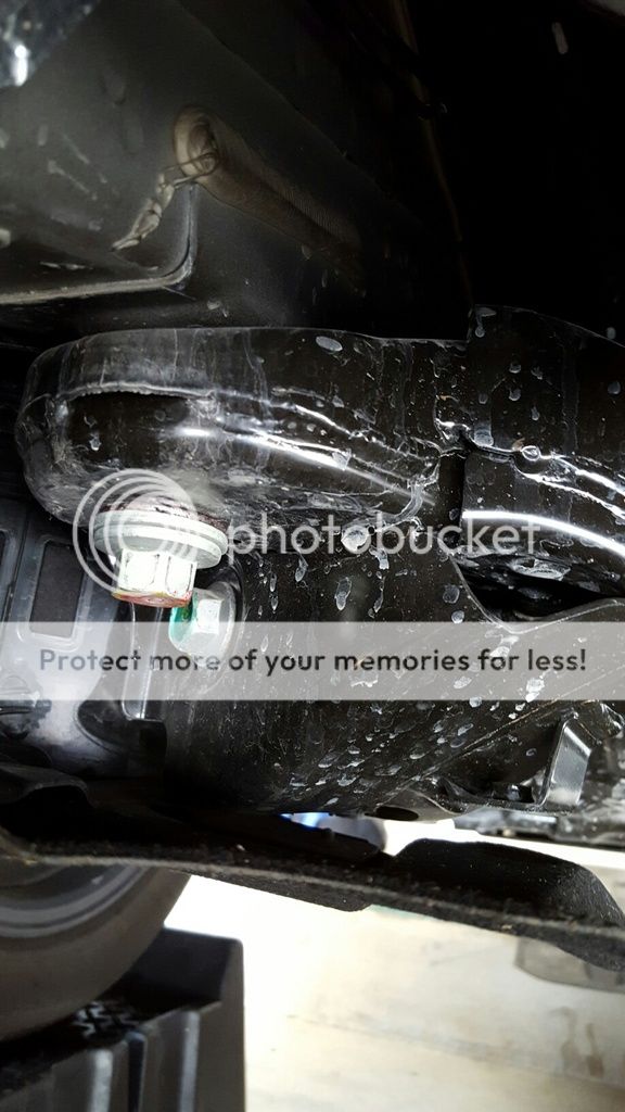

I put in 6 since I could not find anything related to the install of the last front pair. I would assume that they would go on the bolt with the green paint in the pic though. I only installed them on the bolt with the red paint per the instructions. I will install the last two once I can confirm that that is the correct place for them. Overall jacking up the car and removing all the splash guards was more time consuming than installing the collars. It would also be nice if they included a simple pic, diagram or youtube video to clarify things better but you will figure it out once you get under the car.
