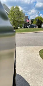

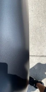

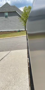

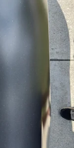

So, I wanted to update you all on my wheels. I decided to add a 5mm spacer on the front. I don't know if it could be any more flush😁. The front wheels are 8.5x19 et+30. The 5mm spacer basically makes the front wheels 8.5x19 et+25. Really happy with the look! Now to find a machine shop that can take 5mm off of the rear wheels (9.5x19 et+35) to get rid of the small amount of poke back there.🤔
I'd also like to take the time to congratulate Stance Wheels for being completely wrong on their recommended numbers😂.
