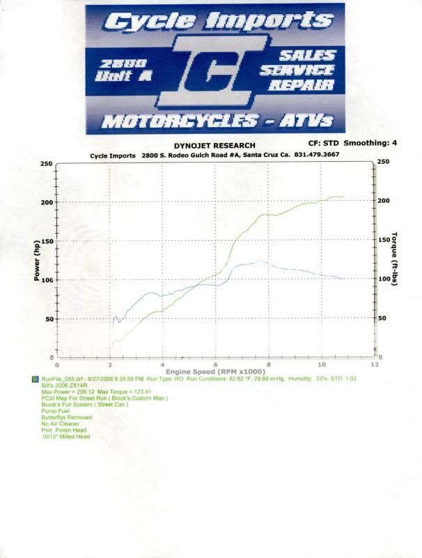

Those Dynos suck. Here is a great Dyno.
Only 600 lbs. and 38 miles to the gallon! Oh, I forgot. It tops around 212 mph.
