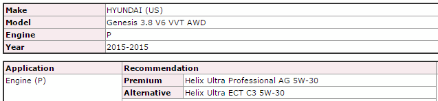

The correct Shell synthetic in the UK for the Hyundai Genesis V6 is Shell Helix Ultra Professional AF 5W-30. However, I would not switch to synthetic until about 3,000 - 5,000 miles with the factory fill, to make sure the rings seat properly with conventional oil.
I used the Shell LubeMatch webpage to find the correct oil and it said Shell Helix Ultra Professional AF 5W-30 for a Genesis V6 starting in 2008. It actually says 5W-20, but I know Hyundai has changed that to 5W-30 for more recent versions of the sedan (you can verify that with your owner's manual).Hi again. Just out of interest I contacted Shell UK to recommend an oil, as it would give some more choice depending on availability of the oils.
They recommended Shell Helix Ultra ECT C3 5W30 and stated,
Based on our references and database, Helix Ultra ECT C3 5W30 is the recommended oil for a Hyundai Genesis 3.8 V6 (2015). This is a fully synthetic oil and it indeed exceeds the API SM requirement stated in your manual - Helix Ultra ECT C3 5W30 is approved up to the API SN performance standard which is backward compatible to API SM.

If you want to call Shell back, and make sure they know you have a Genesis sedan, and not Genesis coupe, that might be good.
As them why their website says AF for the sedan (based on link I gave you).I've emailed them back for clarification and await a response.

I already pointed out that they had the viscosity wrong, and it should be 5W-30 for the 2015 V6.Hi, I received this from Shell.
At least they answered and are being helpful.
Any comments?
Don't pay any attention to that. Shell makes fine products, but it is basically a paid advertisement as part of the global agreement I mentioned earlier with Hyundai. In the USA, Hyundai recommends Quaker State oil (owned by Shell). But I doubt there are any dealers who use Shell motor oil, because they can probably find cheaper ones to use.Interesting to see in print that they recommend Shell Helix.
That is a little confusing, but it appears that newer synthetic oils have lower ACEA ratings, including Mobil 1 products, so I would not worry about it. Keep in mind that Hyundai does not even not specify synthetic oil for the Genesis, so any 5W30 synthetic product you use will far exceed the requirements that Hyundai mentions in the owner's manual.May I ask this? You say That Shell Helix Ultra Professional AG 5W30 is ok to use. But Hyundai specify ACEA A5 (or above) and you say AG is ACEA A3?
