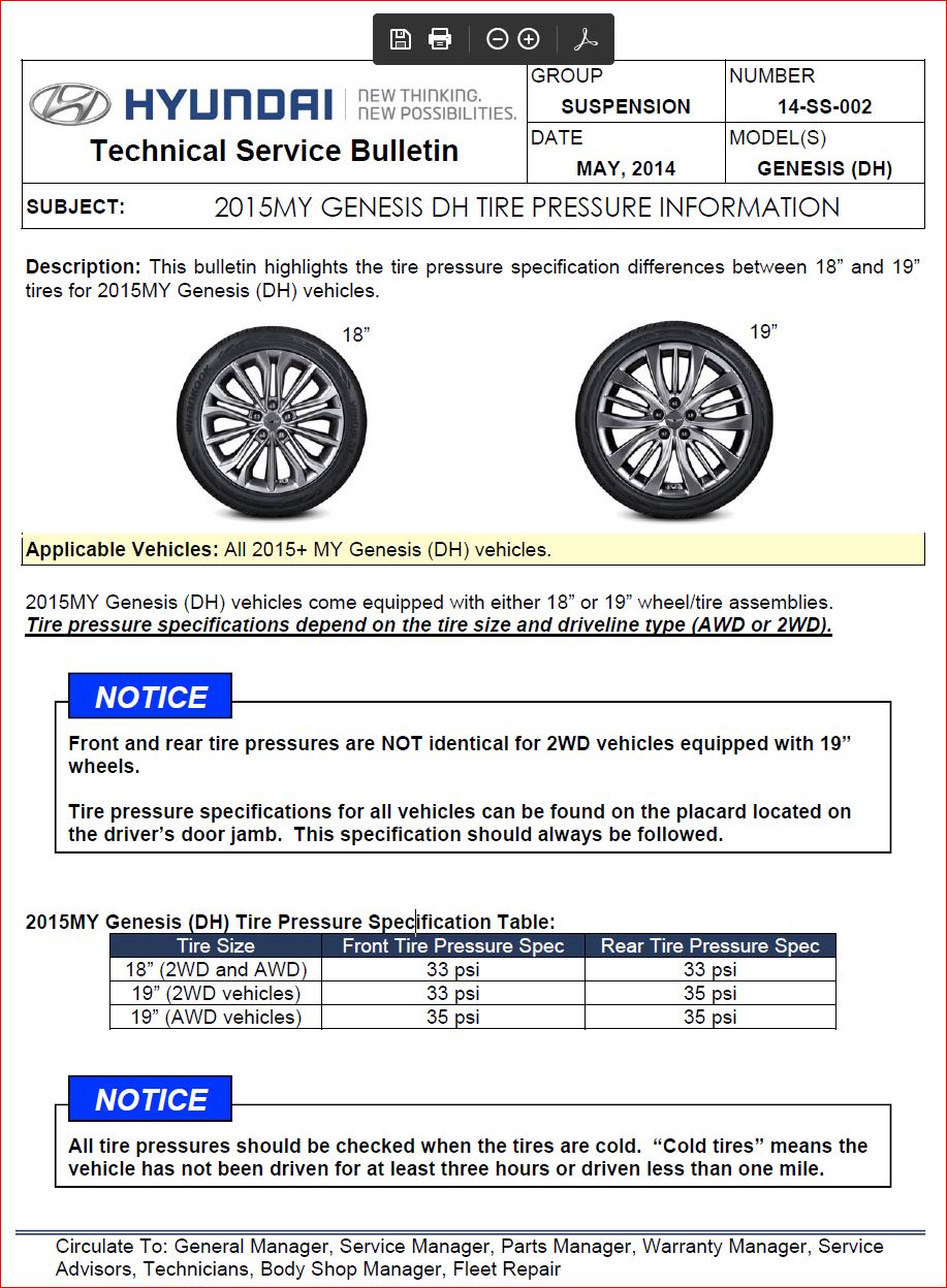

Oh boy, talk about misinformation. The Genesis is delivered with various brands of tires depending on where it is in the world yet the door jamb pressure remains the same. Tires are always inflated to suit an application. Never heard of a tire that has a "tire rating" they only have maximum pressure which has nothing to do with the application unless your car happens to be at the limit of the tires maximum load capacity. Regardless of brand, the manufacturer door jamb is the pressure you need to use.
Agreed. srobak is wrong. The recommended tire pressure has more to do with suspension handling, braking, vehicle load limits, etc, than it has to do with a specific tire.

Mine, on the 3.8 AWD, are 230kPa front and 240 kPa rear.
In Europe the G2 came with Dunlop tires.
Which is pretty much 33 psi front and 35 psi rear - sames as US RWD cars with the 19" rim setup. So same recommendations for Hankook, Michelin, Continental and Dunlop tires as expected!

As I already mentioned, if you use non-OEM wheels (especially non-OEM sizes or non-OEM tire sizes) then all bets are off since Hyundai did not test them for a recommended PSI.
But if you use the OEM rims, and get another brand tire that has same size (including aspect ratio) as the OEM tires, then the PSI recommended on the door jamb sticker should apply.

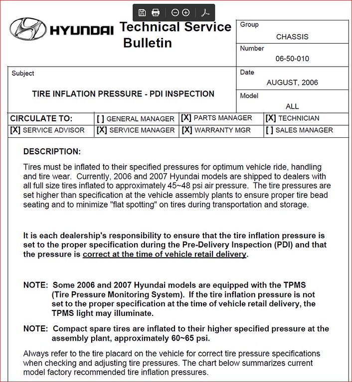

Picked up a AWD Genesis today. Nice car but ride was a little stiff I thought. Close to home I found the TPMS display. It read around 47 PSI in each of the tires!!! Funny. Lowered the pressure to spec. Guess the dealer missed it.
Guess he missed it is just the real world talking to you. Basically they take off the protective film, wash the car and hand you the keys however they are supposed to actually do dozens of checks which they are too lazy to do. Sometimes they go way overboard and adjust the clock too! :roll eyes: Sad but true.
Sort of like the Hyundai CPO (Certified Pre-Owned) program. It is supposed to be a "comprehensive 150-point quality assurance inspection by a Hyundai dealership technician."
But as many members have reported on this forum (based on problems they discovered as soon as they drove a CPO vehicle off the dealer lot), most dealers don't actually check anything other than to make sure the car starts.
