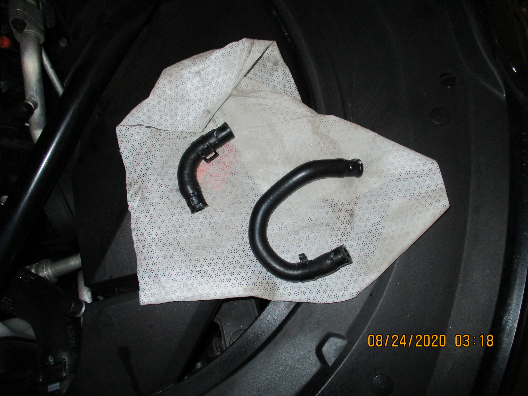

Today I did the coolant bypass. I decided to just use a high quality 5/16 coolant hose to bridge the throttle body coolant ports and bypass the throttle body. The hoses are pretty short. However, the darn factory hoses were literally glued(black sealant) to the hose nipples. It took me forever to remove just one of the small hose end from a nipple. When I test fitted the 5/16 replacement hose I just cut off(split the end with a razor) the other stock hose ends. I only need some 5/16 nipples to cap off the throttle body port. If I have no leaks than it should be good to go.
I may order the two stock hoses(depends on cost) to use just in case I need to go to the dealership for any repair work. I do still have an extended warranty until 100k miles, so they would look for any reason to void it.
I will give some feedback on how the car performs with the coolant bypassed.
The throttle body coolant hoses bypassed with a single connecting 5/16 coolant hose.
The small stock hoses. Not much to them except that they are a pain to remove.

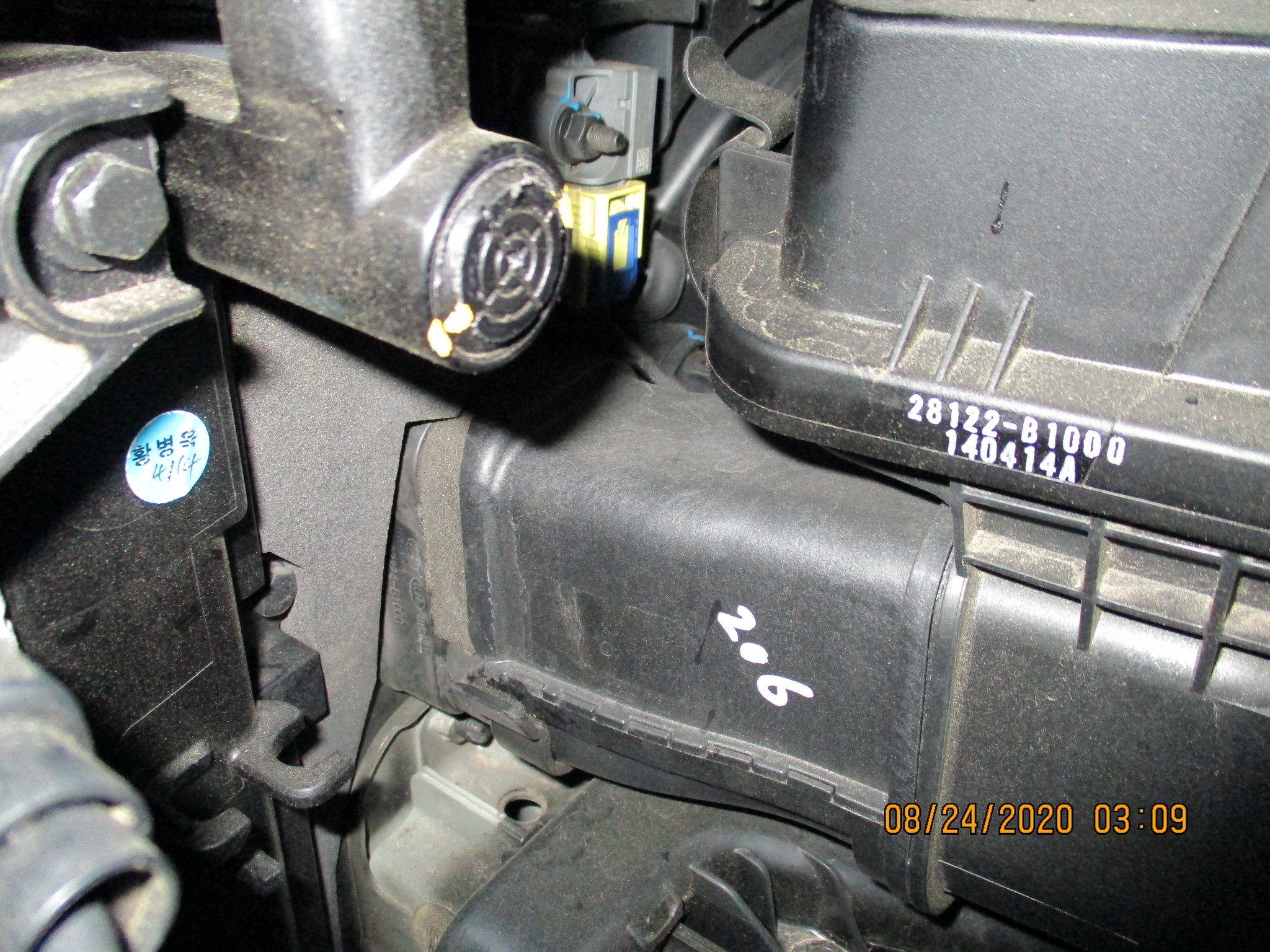

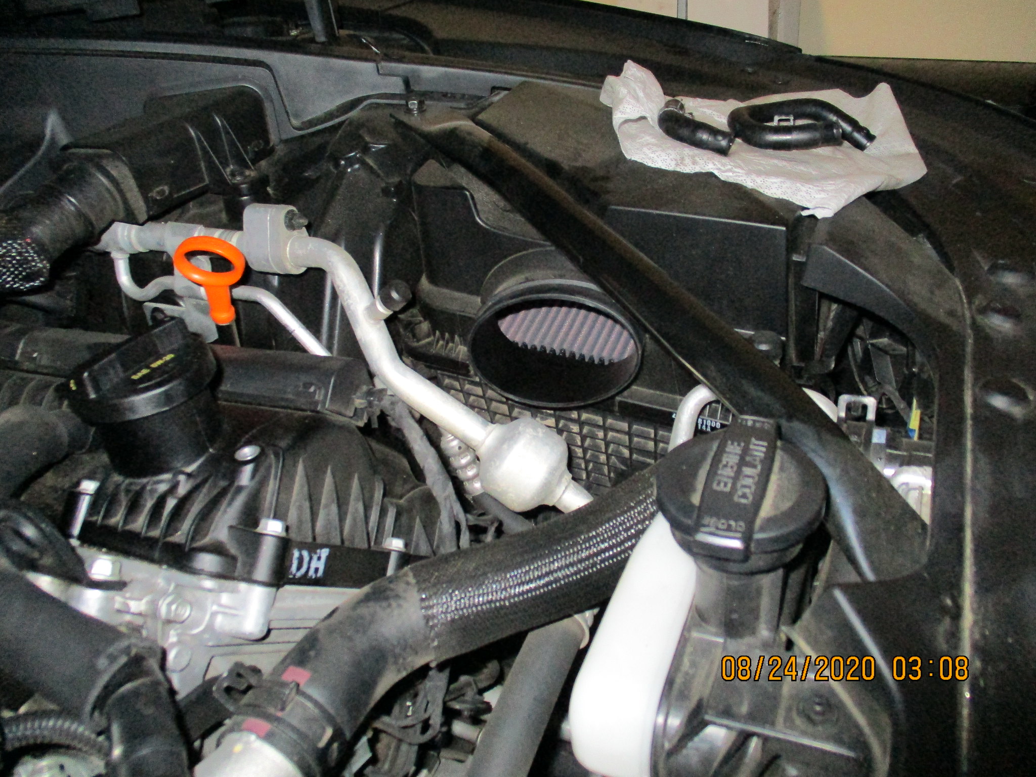

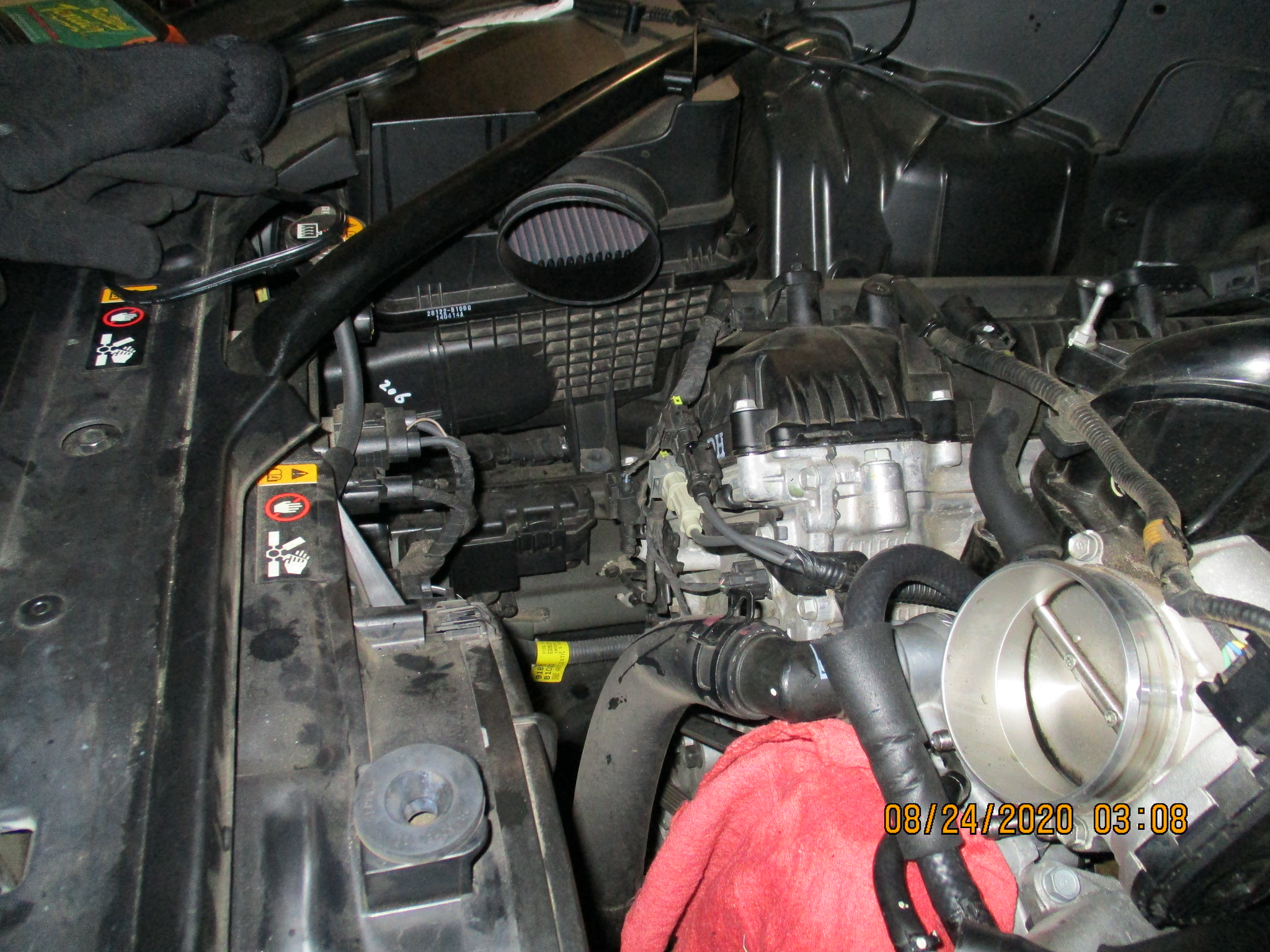

I also took a good look at the stock air-boxes and the layout of the engine bay. The engine bay has too many hose and lines on the driver's side to even attempt to bypass the stock air-box. I also noticed that the center section of the air-box also support the radiator fan. My radiator fan moves a bit with the center section removed, so I guess I will keep it.
It looks like the stock air-box is good for what it is, so I will just leave it as is. I may remove the protective end caps(shields) located on the end of the intake ducts(behind the front bumper) that prevent large debris from entering the intake. The stock inlets are small, but does pull in cool air just under the headlights from the grill, so not a bad design. I also may cap off the holes in the center section to smooth out the airflow while being able to keep the system as stock as possible. So I will just tweak my stock air intake since it already a true cold air intake system.
The 2015+ 5.0 stock air-boxes are not perfect but well designed to be honest. They seem to flow more than the 2012-2014 5.0 models with the single air-box, so the gains with an intake may be less than a 2012-2014 due to stock intake system already being better designed to pull in cooler air from twin air-boxes.
Passenger side
Driver side
Center section with holes that can be plugged to bypass the baffle boxes.
Hmmmmm... Tight clearances on both sides for sure. I am still going to remove the air boxes completely when i get a chance. I think we need to know where from and how much fresh air they are getting. There'd be no point in throwing cones in those corners if there isn't an ample supply of fresh air for them to use. Even with a heat shield.
I suspect that the inlet to those boxes are small, and/or convoluted, to keep impurities out and noise down. Finding a way to increase flow to the boxes may be our next best option.

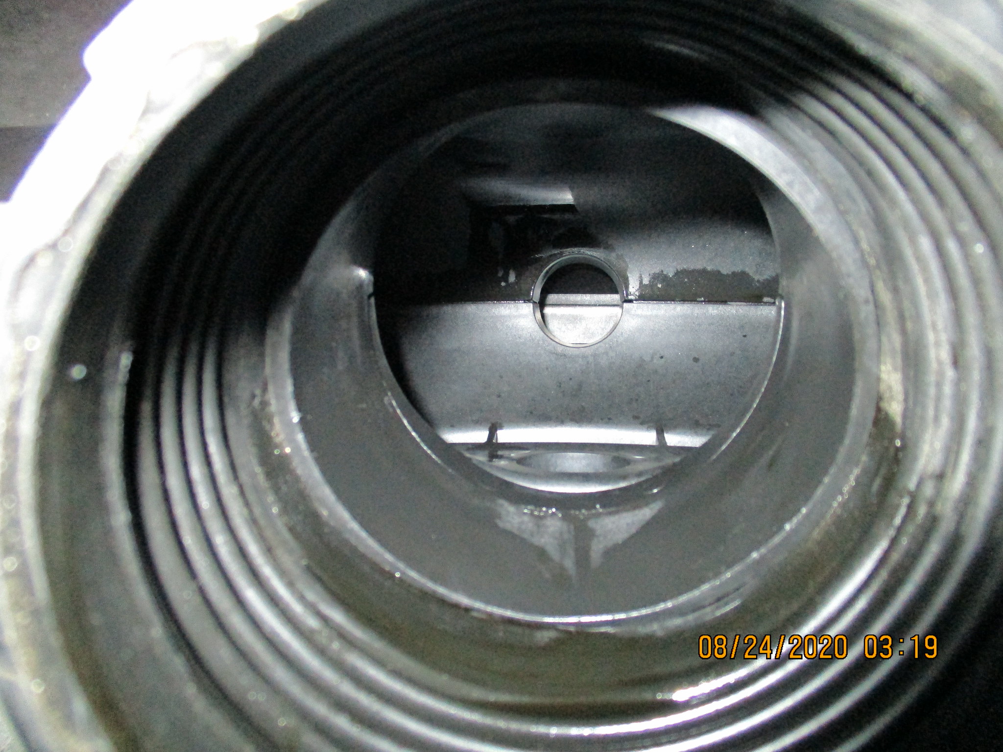

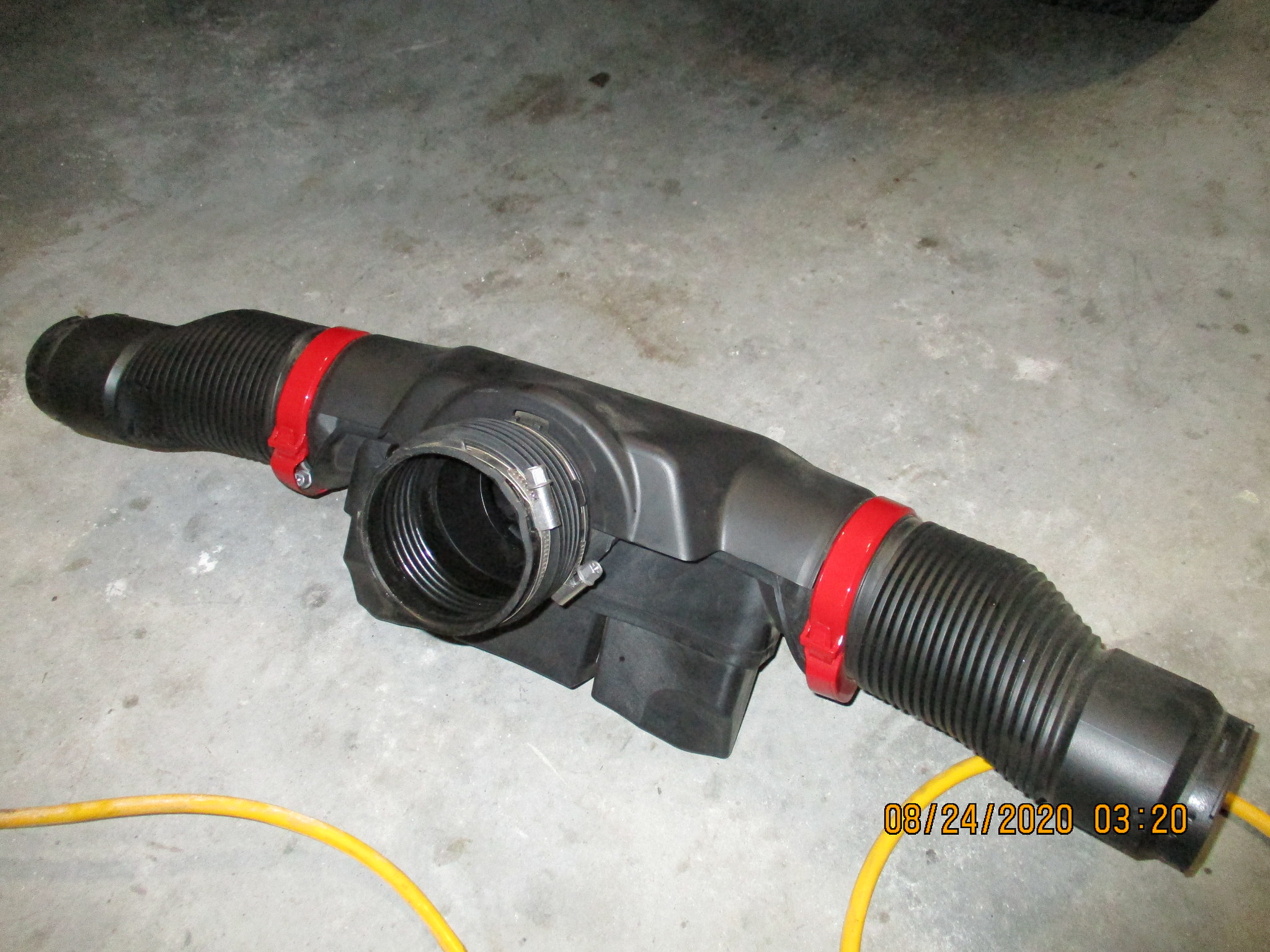

I ordered some rubber plugs to seal up the resonator holes in the center airbox junction assembly. It looks the bottom half the center junction piece can be removed. The bottom portion of assembly can be ordered as a replacement part, so it should be removable. I will remove the resonator box and fit the plugs so the larger ends of the plugs fit inside the resonator portion just in case they come out so they will not be sucked into the engine, but just fall into the lower resonator box.
The bottom portion part number is 28191R. Hopefully I can access the holes from the inside with it removed and plug them. The shields look like they may only attached to the ducts which are held by screws.
