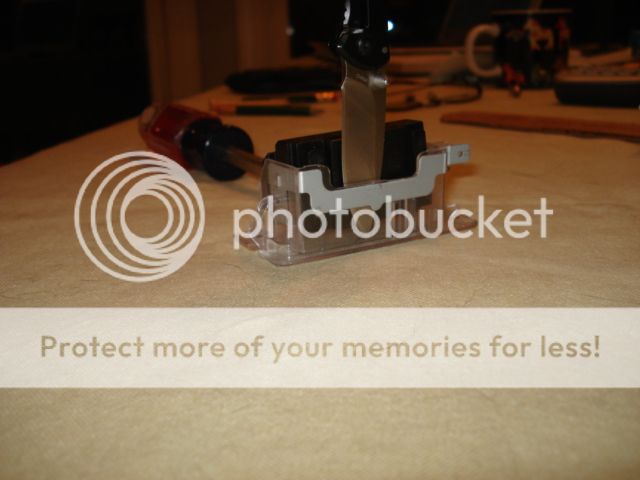

I managed to get the trunk light unit disassembled without breaking anything. This is my first attempt at posting pictures so wish me luck.
With the assembly out of the car insert a thin knife blade down between the black casing and the metal strip which runs along the inside of the clear housing.
Gently twist the blade to allow the 2 black tabs to disengage from the metal strip. The tabs are 1.5" apart.
While pressure is being applied to release the tabs insert a flat bladed screwdriver on the other side between the bottom of the black case and the clear lens assembly. Twist the screwdriver to apply force so that the black case separates from the lens.

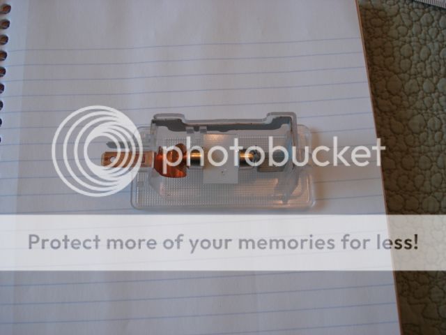

What it looks like with cover almost removed. Bulb = 31mm festoon.

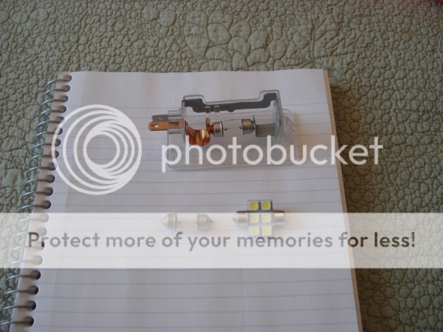

I got my trunk light LEDs from Diode Dynamics. They replace the incandescent 31 mm festoons. Each one has 6 LEDs. They cost $8 each.
original bulb & new LED
LED installed (LEDs facing down)

Note that the trunk light assembly was replaced without the black cover. It wouldn't fit with the new LED.
