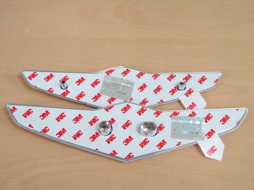

What about this one? Although it seems that one with the bigger pegs would be the front wing since it's a bigger wing. That kind of sucks to have to take the pegs off, but it is what it is I suppose.

Yes, the one with pegs closer together is for the hood. If the new larger wings are like the old ones, the front hood wing is slightly curved to fit the curve of the hood, and the trunk wing is flat.
Taking off the pegs is easy with a Dremel Tool. Anyone who installed the front wings on a 2009-2014 have had to remove the pegs, and there are many posts about how they did that.

Taking off the pegs isn't the main concern, it's having to make sure it's 100% aligned correctly.
