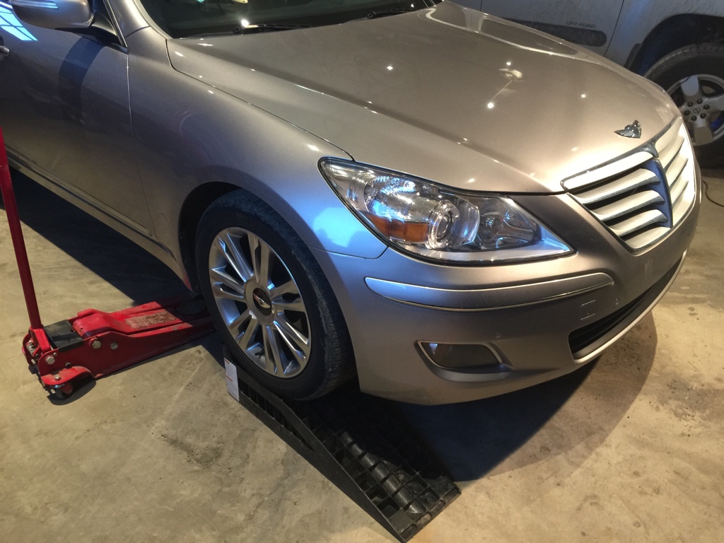

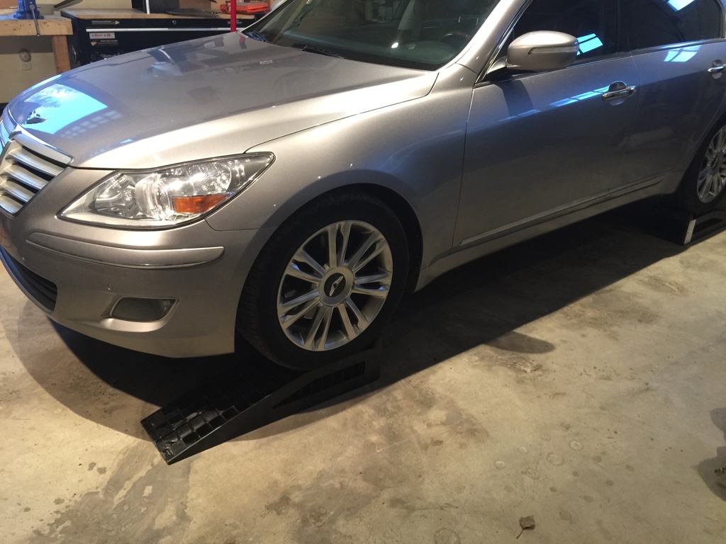

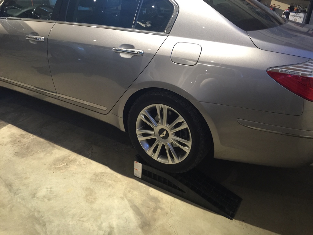

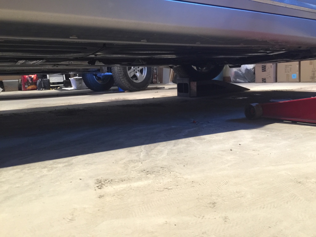

I thought they were from Ontario. Anyhow, installed my last collar yesterday. Turns out that BOTH parts of the subframe on the front needs to be supported if the screws are not catching on.
As well, ramps are a lot better than using jack stands to get the collars installed.

I like that ramps idea keep the suspension under load would have made the back easier I had to use a jack to put a load on the suspension.
