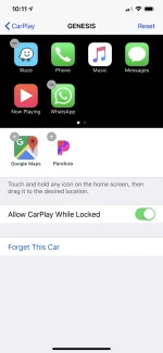

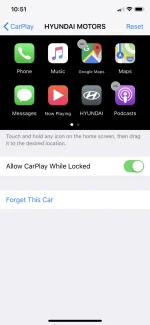

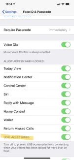

Even if the cable works on other car(s), Genesis will tell you to use an original Apple cable, just FYI. I have intermittent connection issues. Yours sound more like a problem with a phone setting... e.g. using car play when locked.
