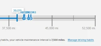

After 4 months of following up , and taking the car to the Hyundai Dealer several times , i am almost at a point of giving up BlueLink. Its not worth the hassle i think.
All my trips to the Hyundai Dealership are getting updated in the myhyundai service schedule.
19700
Now HMA is saying this -
"Please be advised the head unit has a 3 year/36k miles warranty and the vehicle is past the warranty parameters by time"

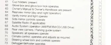

But HMA is not able to prove me answers as to why the CPO car "Inspection check List" has not got checks for the Head Unit - BlueLink in the check list .
