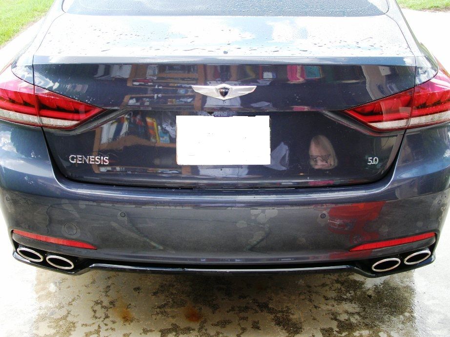

Went with the clean look on the rear...

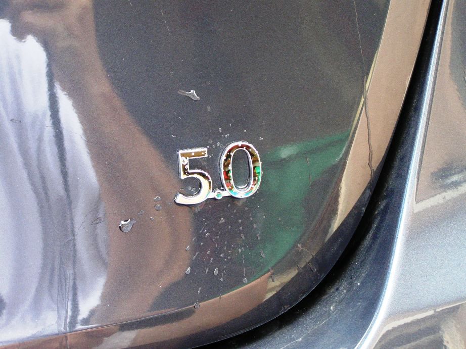

Before:
After:
If anyone is interested, I can post pics of the process I used and tools needed to perform this surgery :D

Looks like a standard bikini wax to me.
Looks nice and clean. I may d-badge mine tomorrow, completely.
What's next for the driver, this:
Is it that you just don't like badges or did those badges bother you?
Looks much better, as do all cars that get debadged.
Should be mandatory.

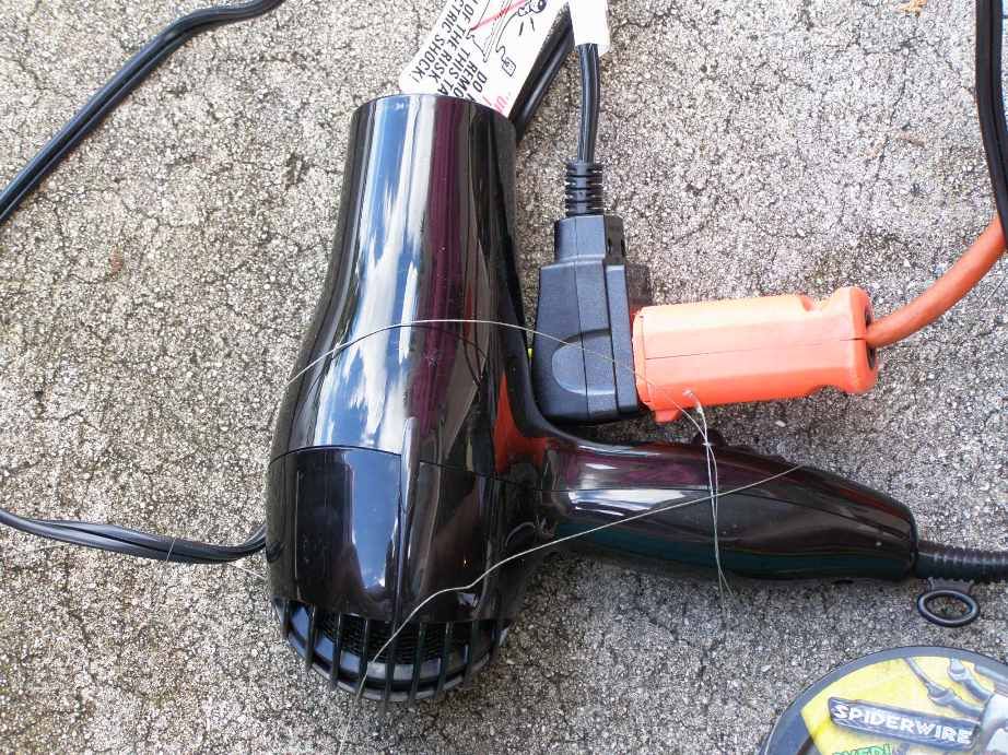

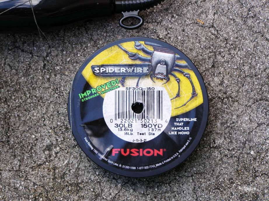

Tools required (or something similar):

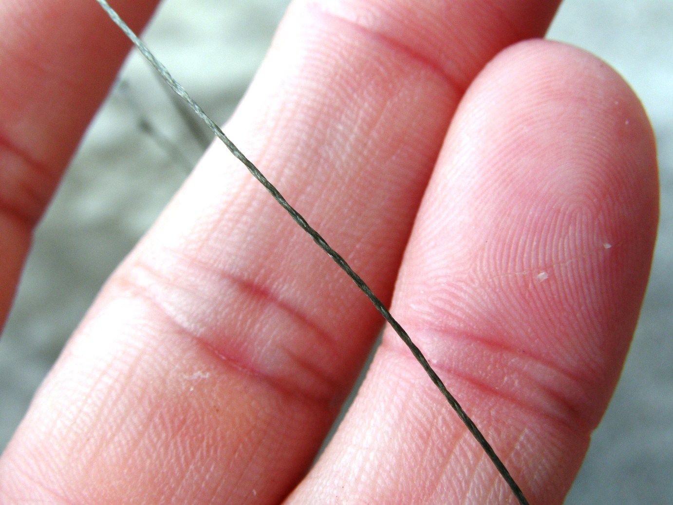

I used spider wire braided fishing line but regular line will work.
Regular hair dryer
Turtle Wax Label & Sticker remover (or Goo B Gone);
Have someone hold the hair dryer onto the items you want to remove. Take the fishing line (wrap a couple of loops into each hand with about 12" between hands) and slide it under the edge of the item to be removed.
Now work it back in forth putting pressure on it as you pull it through. The item will come off as shown below leaving a layer of adhesive.
