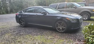

New wheels, window visors and Osram cool blue boost HID bulbs20200223_164321.webp
So far in my 2015 Genesis 3.8 AWD Ultimate....
1. Painted calipers red....will add Genesis in white letters tomorrow
2. Added Mobis LED foglights
3. Installed a switch for the fogs on the fuse access panel, left of steering wheel
4. Added a Bazooka powered subwoofer and tied it into the factory amp. Sounds fantastic and would be an easy upgrade with what I know now.
5. Replaced the yellow DRL's and turn signal 1157 lights with Sylvania LEDs. All white, all the time (not racist, just not switchback yellows)
6. Installed the AEM Cold Air Intake. Very satisfied with the improvement in sound, particularly from 2300 rpm to 3000 rpm. My butt-o-meter says the car is quicker but I'll probably never know for sure unless I race my wife in her 2015 Genesis 3.8 AWD Ultimate.
I'm running out of stuff to do. Any ideas? Want more power....

Greetings!
I purchased a CPO 2016 Genesis 3.8 RWD sedan w/36K this last January and love this car!
Joining and reading this forum since then, I was able to decide and upgrade a few things on my car, thanks to YOU members! Here is a list so far...
⊙ Staggered Element EL006 wheels: (F) 20x9 +30mm - (R) 20x10.5 +42mm
⊙ Nitto Motivo tires: (F) 255/35R20 - (R) 295/30R20
⊙ Ultra Racing bars:
a) Front Strut bar part #TW4-2748
b) Rear Anti-roll/Sway-bar (20mm) #AR20-488 (stock is 16mm for the 3.8 V6)
(w/greasable & thicker Mevotech rear stabilizer bar Links: Left #MS908105 - Right #MS908106)
c) Middle Lower bar #ML4-2750
d) Rear Lower bar #RL2-2753
e) Rear Lower bar #RLS4-2751P
⊙ K&N drop-in filter (no magnet on flapper in air box)
⊙ Red painted front brake calipers w/custom 6" G-wing high temp vinyl decal stickers.
⊙ Red MGP rear brake caliper covers w/custom 5" G-wing high temp vinyl decal stickers.
⊙ Custom G-wing vinyl decal stickers for new wheel center caps.
⊙ Blackout vinyl wrap pieces for front & rear bumpers.
⊙ Window tint @35%
...Future Projects:
⊙ Custom Exhaust - Eliminating the 2 after cats
⊙ Eliminating OEM center muffler and replacing with Magnaflow SS X-muffler #11385
⊙ will be keeping stock mufflers for now, till I hear what it sounds first.
⊙ ....will see...maybe a dyno tune at BTR Tuning since they are very close to me
I know, I know, alot of you will say "SHOULD OF GOT A V8" lol
...but I'm very happy with the V6, plus the gas mileage is great, especially with the RWD and the price was right!
