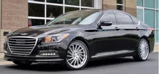

yes, i ordered both sets from ARK since i didn't know for sure what route i was going to go with my Genesis hTrac. I started with the F springs with my 22" wheels because I knew the S would be too aggressive. after 3 tires in 3,000 miles, i decided to go back to 20" wheels. i thought the F springs were very good, near factory ride in my opinion. Which the 20" wheels on, i decided to try the S springs. i LOVE how it looks, the ride is a bit more "bouncy" than the F springs, but i am nit-picking at that. they ride great as well. my only issue with S springs on my hTrac is the camber is out of spec on all four corners and it cannot be adjusted apparently. I drive A LOT (30k miles + a year) and don't want to be replacing tires 3 times a year.... :(
on mine, the F lowered the car .75" all around, and a tidge over 1.5" on the S springs on all four corners.
if i can't figure out the camber issue, i will probably go back to the F springs, for the sake of tire replacement cost..
first pic is on F and second is on S:
