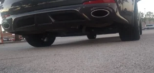

I got the answer to my own question today. 265/40R19 WILL fit in the front on stock suspension. My wheels are aftermarket, 19x8.5 +30.
You can fit maybe 1 or 2 dollar bills through and that's it 🤣. But the most important thing was that they didn't rub. Once the tires come in and are on the car. I'll post some pics
Why go that big? Well I'm running a 305/35R19 drag radial in the rear and the 265/40R19 is the size needed to stay in spec. Also, it looks pretty badass IMO.
Mission complete.
265/40R19 fronts
305/35R19 rears.1000006166.jpg
Welcome to the 300s. You got an even wider setup than me in the front and more sidewall so I’m wondering how that is
So far, so good. It's extremely close. However, it didn't rub and that was one of the main goals. Didn't need spacers either. This is stock ride height, no spacers.

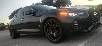

Sorry if anyone's seen this pic already, just got a new setup. ESR RF2 19x8.5 +30 with a 7mm spacer and 19x9.5 +35. 245/40/19 and 275/35/19.
About the subject of this thread, if anyone's reading this and thinking about aftermarket wheels and tires, I just want to second what Volfy said. I've been through 4 wheel/tire setups and this is the thinnest set of wheels with the tallest sidewall i've run yet. Just remember that while 10 inch wide wheels with a 305 tire might look nice, it might not dynamically be the best.
I have almost the exact same setup. Why did you use the 7mm spacer? Also, what lowering kit are you using?
Wanted the front wheels to be perfectly flush!
I'm on Yellow Speed Racing coilovers which are really great. They're not cheap offbrand stuff, never heard of them, but they ride nice.
