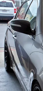

This is a 295/30r20 on 20x10 +40 rohana rc10 on BC coilovers DS series 10k extreme low coil. No rub. But I also spent a stupis amount of time to dial this in.. honestly for a 20x10 285 wouldve been my preference with a 255/35r20x9 fronts.. but when I needed tires there was a national shortage ofc. But 295 is the widest you can fit inside the oem fender
To give you an idea how close it is to the suspension on the inside
