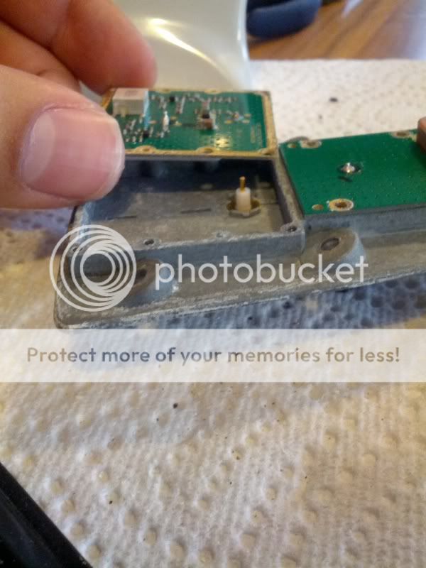

I took mine off then examined it before disassembly, where I could see why it failed. There is a rubber gasket that was not properly installed at the factory that was allowing water to get inside the assembly.

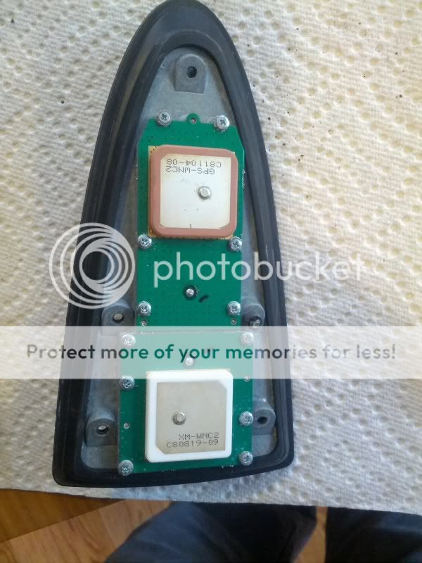

The bottom of the antenna has five Phillips head screws that hold on the plastic "Shark Fin"
Removing those reveals two circuit boards that have the actual antennas mounted to them, both held in place by six Phillips Head screws.
I removed the board for the XM antenna, very carefully prying it straight up to remove the Teflon insulator from the middle of the antenna connector and it revealed a pocket where water had sept in under the gasket and was shorting out the board.

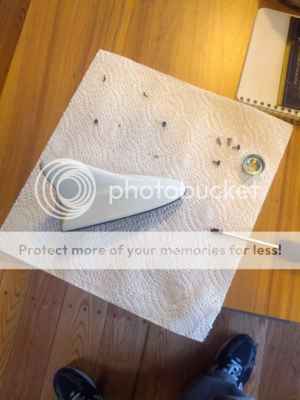

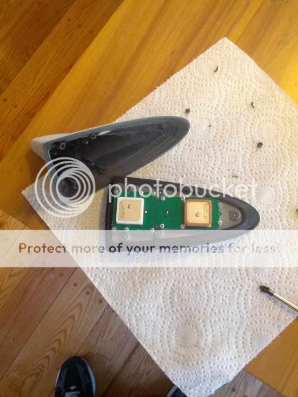

Well I got around to pulling down the head liner to see what the deal was. As mentioned above just pull down on the edge of the liner and it will pop out.
There are two connections. One for Nav and the other for XM.
There is a large nut you need to unscrew and I used a 3/4" which worked fine.

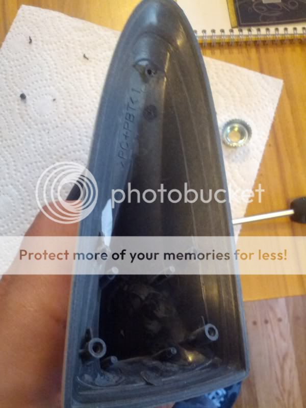

Once I got everything disconnected I notice all of my screws were rusted. Some really bad and was hoping they wouldn't break off or get stripped. Anyway, that wasn't the case. Here are some pictures of what I found.
Notice how the above picture shows the screw posts in the plastic fin broken off? All of them but the back two are actually still in tact. Probably how the water got in.
Corrosion white powder...
Not sure if this is where my problem was or if I just broke the "needle" piece but none the less it definitely won't work now! :(
So it looks like I need to order up a new fin. My XM got so bad that it basically wasn't listenable. Anyone know where I can get one other than the dealer?:cool:
Looks like a bad design. Water leaking in the device and likely the inside of the car? Thanks much for the pictures. This should be a warranty item as I see it. Not damaged.. Bad design that caused the moisture destruction.
