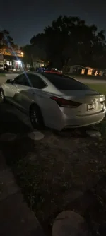

Well.... She gone lol. Didn't feel like goin much further with it so.. 🤷

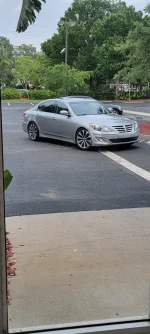

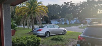

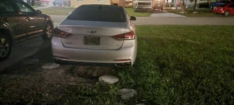

oh sorry, those pics were of the new one ( it was 9:45 at night when I took those photos; I'll get better ones later) this was the old one.
