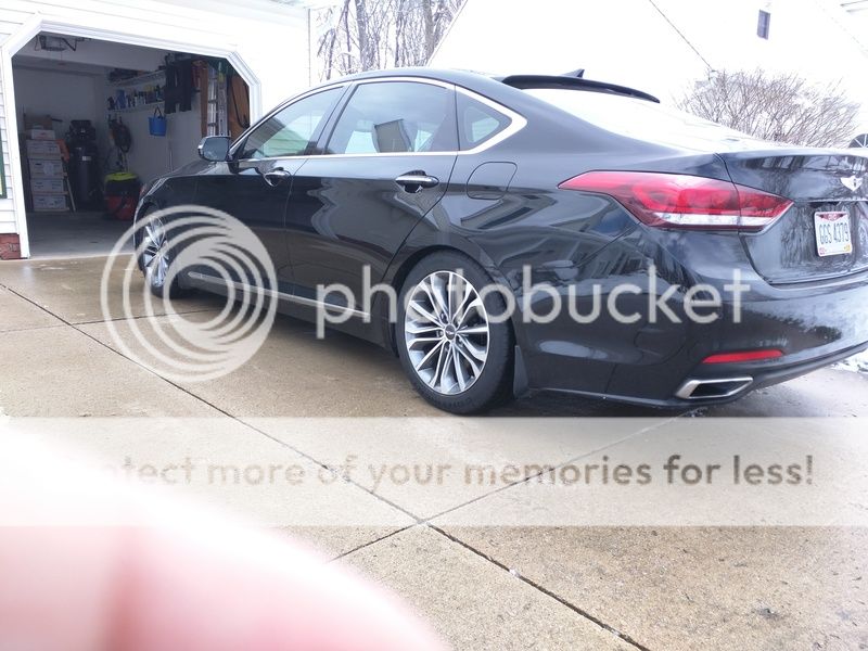

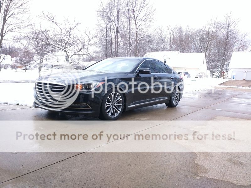

So it snowed here so, I'm going to do the new rims and alignment on Monday. It took me around 6 hours to complete everything. I took a bunch of pictures along the way to maybe do a how to. Fronts( about 4 1/2 hrs) area B but the rears(about 1 1/2 hrs) are a piece of cake.
Car height before drop was 28" all the way around, after drop and test drive the car is down to 26 1/2"
Yes I know my finger is in the pick
Nice! You happy with the drop? Which springs did you go with again? Looks really good!
looks perfect.... congrats
Thank, yea I'm happy with the drop not too aggressive but no wheel gap. I went with ARK springs.

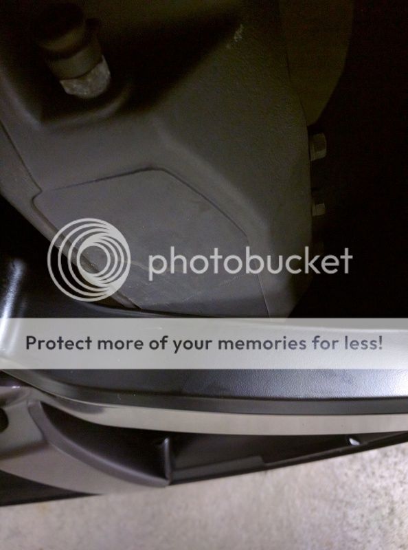

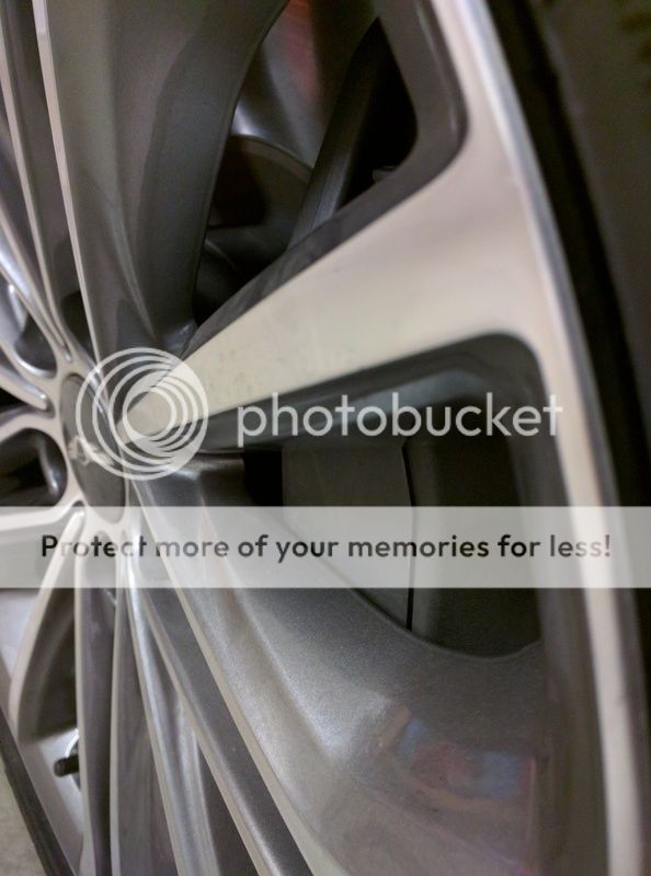

So I test fitted the wheels again after lowering and the front barely clear the calipers but they do. I'm going to get 3mm spacers for the front so I have clearance when the calipers expand(heat up). Factory are rear close to the calipers too. The rears with the suspension loaded, I can fit my hand all the way around and I have pretty big hands.
Factory clearance
New Wheels
i'm confused as to why your having clearance issues with the stock wheels after lowering? Am i missing something else that you might have did?
No I don't have clearance issues with the stocks. I just wanted to show how close the stock ones are. It is recommended to always have about 3mm of clearance because of heat expansion and I'm showing how the factory are like 2mm clearance and my new wheels are about .5mm clearance. I just ordered 3mm spacers just for the fronts.
Looks good, thanks for the pictures! I'm thinking if I do it, I may add spacers to push the wheels out just a little bit, maybe 15 mm.
The wheels are pretty flush but you have room to play with. I hate using spacers, but in my case I have to because the calipers.
