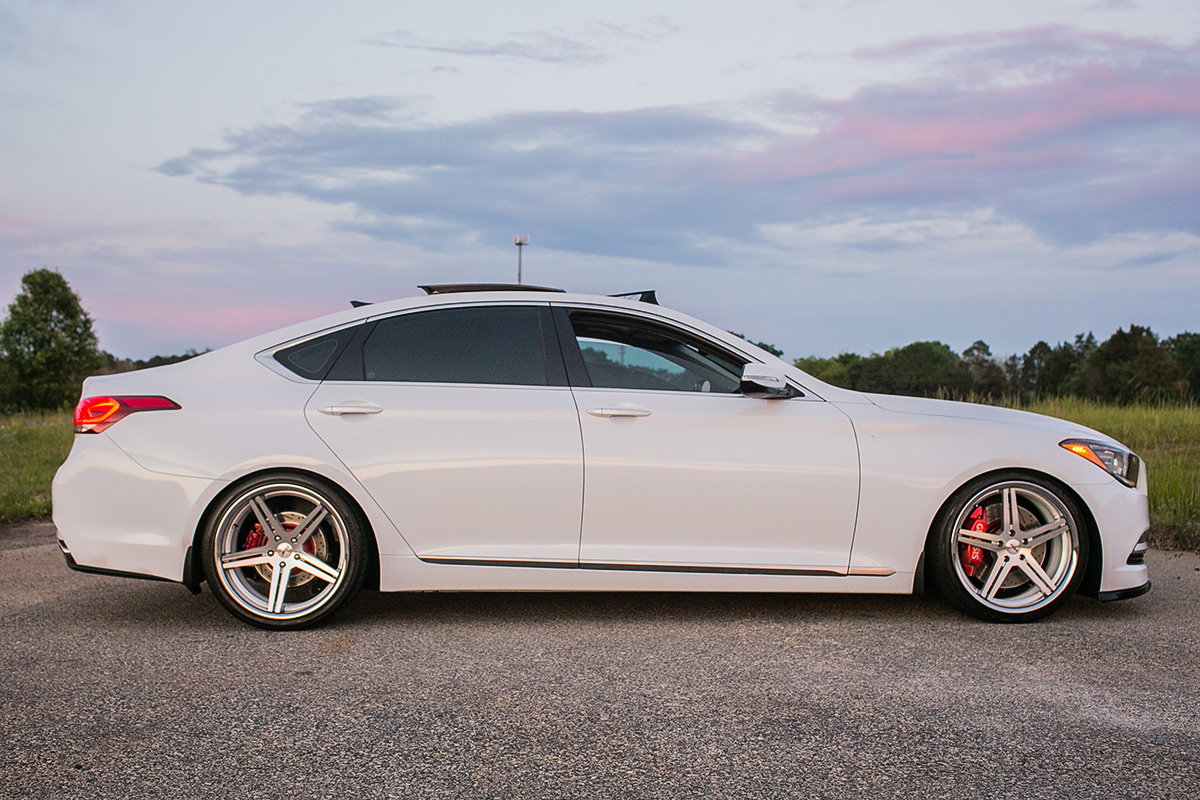

I know this thread is old but just got my lowering springs installed last week. Loving how it drives. Now for some wheel spacers. Anyone with ARK GT-S and stock wheels? What size spacers should I get? View attachment 17609
Hi. That looks awesome!

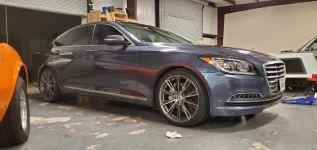

I am trying to figure out how mine is raised higher on the front end than the rear.
Did you have this issue at all? See pic.

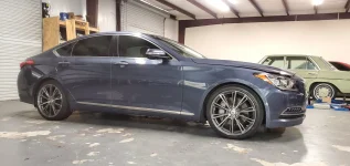

ARK contacted me to let me know they had an opening a day early for install. As promised here are pics of the car on the new set of springs. As mentioned earlier, these are gold and are confirmed to be slotting in with their GT-S line. Their GT-S line is a lot more aggressive than their orange GT-F line, which I suspect I had on before these although it was never confirmed.
The springs I had on before measured 27.5" from the ground, through the wheel centercap, to the apex of the wheelwell arch. These new springs measure 26.75" using the same reference points. Unfortunately, I did not measure what the stock height was so I do not know how much lower the car actually is.
According to the guys at ARK, the first springs only lowered the car 0.75" while these lowered it 1.3"-1.5". Again, I could not verify this because I did not take before measurements when it was stock. Maybe somebody who is stock can measure using my same reference points and let us know how much of a drop it really is.
Overall, I am extremely happy this time around with the drop, as the wheels are visually flush with the fender. There was no rubbing whatsoever from any corners, even at full lock. The ride is surprisingly even more comfortable than it was with the other springs. These are not stiff in the least bit and I am definitely not riding on the bump-stops.

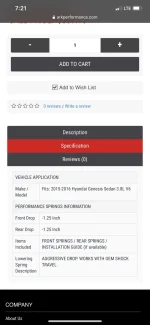

They look great! I want that exact drop. however I went to their website and it says it only drops the car 1.25 all around. Is that the same one you got ? I have the same car you have 3.8 2015 genesis sedan
I have the same problem did u fix it

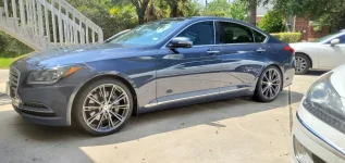

This is stock
and this is after the front were installed
Rear done and driven home front just sits up to high
