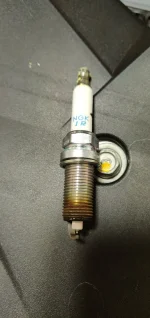

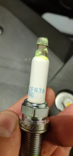

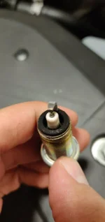

Many already know this, but I figured I'd post it anyway.
The OEM G70 Spark Plugs are the same as the Stinger's, as in they are NGK Iridium plugs, p/n SILZFR7A. The gap I measured on mine was approx 0.0345", which would make sense as these are supposedly at a factory gap of 0.9mm (0.035").
These are decent plugs, but there are certainly better ones out there. The electrode is relatively thick for an iridium plug, but one nice thing is the tapered ground strap.
Pictures...
19854
19855
19856
19857
With the 7 heat range the ground and electrode are looking pretty clean.
