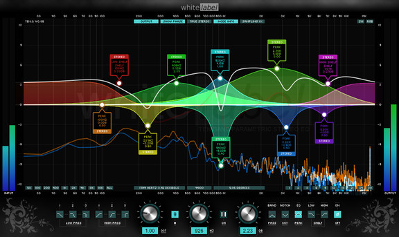

  1. I'm not aware of any apps on IOS or Android that allow you to use plugins such as WhiteLabel EQ
  2. Really doubtful that a phone would have enough horsepower for applying sophisticated DSP in realtime.
