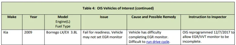

Just an Update to this saga. With respect to the Kia Borrego the California BAR has admitted defeat! They have programmed their smog testing equipment to ignore the EGR monitor on the 2009 Kia Borrego (with the 3.8 V6). What this means is that even if your EGR monitor is incomplete you can still go for a test and it should pass.
This does not however help Hyundai Owners with the 3.8. I am not sure how we would go about getting the Hyundais on the OBD problems list. It seems with the Borrego they took one look at that drive cycle and said that is way to complicated. Perhaps if Hyundai put out a similar bulletin it would garner the same exemption. Just a thought.
Link to the complete CA OBD Guide : https://www.bar.ca.gov/pdf/Smog_Check_OBD_Reference_Full_Version.pdf
