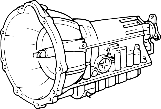

Automatic transmission diagrams
UnitType
TB-60NTransmission
Transmission
