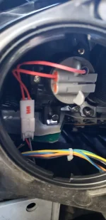

You might have to swap 2 pins on one of the plugs
Do you have to do any rewiring of any kind to use the Sirius? If they are not plug and play, I'm not venturing into LED.
Yeah, it's not unusual to have to flip the 2 red wires. Incandescent bulbs can operate without regard to polarity, but LEDs need to be correct in order to work. A good majority of our cars are wired backwards. It took me all of 10 minutes to switch the wires in order to get the LEDs to work. The entire project took me about 30 minutes from start to finish. That's including removing and re-installing the air boxes.
