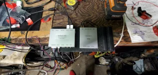

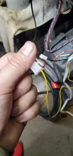

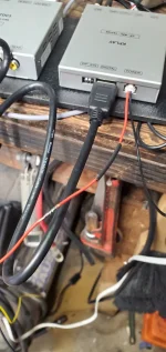

Hey guys so weather is freezing so dont have the best amount of time to stay out and fiddle with it i installed the system in the glove box ran the wires through a hole up to the screen, came with no directions but theconnections are straight foward except for the can h/l signal that from the only video on youtube apperently goes to the i-box ass module what wires i have no clue so im stuck there untill i get more info from the company, will be making a new thread once completed on installation heres some rough pics so far

Can anyone get a wiring diagram for the ibox connector?
That's what I was afraid of - the website had almost no practical instructions for the normal em effer... Guess you'll have to watch that guy's video until you can figure it out. Kinda sucks, seems like that they have it figured out....
I think you're looking for pins 9 and 10 to hook the steering wheel CAN data. It's not multimedia CAN on 31 and 32.
On an unrelated note, seeing the cellular antenna called HSDPA worries me- that's going away with 3G service...
Figured it out thanks for the help guys tho thr can high low has to go to the ass'y ibox cant upload the vid, at wrk rn will get more posts later it works, that being said only when the car is in the on position, must be put into aux then long hold the call end button and it turns on before u do anything u must press anywhere on the screen for about 12 seconds then it goes to a calibration touch screen after setup its straight forward from there, andriod auto only works plugged in the only way to work it is through touching the screen dont use anything else because this is an overlay system so if u use the jog dial u coule be going through the oem system without seeing cause the screen is hijacked by the new car4play interface overall its an okay system want to root my phone so i can put youtube and Netflix on it to see if it works while driving, it should work
