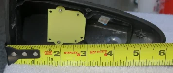

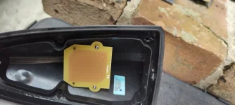

My 2018 G80 shark fin antenna was loose and stumbled across this thread. I was able to pry it off by breaking the front attachment. The pictures below support exactly what @joegr measured and hope it helps anyone else searching for the same. I cleaned the area and used the E6000, since I did not have RTV. Seems pretty solid after a couple hours.

A lot of good information in these posts. I didn't see these when I posted yesterday "Shark Fin Antenna Came Off". In my case, I think the 5 screws holding the fin in place broke over time...1 or 2 at a time. Finally, the fin just lifted off. There are several different glues recommended here. I used Loctite because my neighbor had some and recommended it. Comes in a small tube, easy to use and is not messy. I laid a bead all around the black rubber gasket that the fin sits on and put the fin back on it. I'm not going to push on it too hard, but it certainly feels secure. My advice is to get whatever glue you choose and keep it for when your fin gets loose or comes off. Those screws are delicate and probably will break over time.
@ joegr...I never knew where the different antennas were until you posted it.
@pmcjr - To clarify on your message quote "In my case, I think the 5 screws holding the fin in place broke over time...1 or 2 at a time.", did your antenna screws break or was it the female plastic threads from your shark fin deteriorate?
In my case and from the pictures I included in my previous post, 4 of the 5 female plastic threads broke off from my shark-fin cover. If the metal screws are damaged/broken, then you'd have to replace them by removing the headliner, which most of us tried to avoid. Since you used Loctite, it seems you've done the same.
@ted33021 I believe it was a combination of both...broken off screws and broken plastic threads. The fin was becoming loose over time and, one day, it just lifted off completely. Thankfully I was home and wasn't driving the car. It definitely would have come off and gotten lost. I didn't have time to mess around. It needed to be fixed. A neighbor, and Loctite enthusiest, helped me and it now seems fine. I think a dealership would have fixed it with glue also. Going up under the headliner seems way too extreme. Lesson learned...check your Shark Fin from time to time. The fin is not all that secure given age and normal wear and tear.

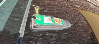

I have a 2017 Genesis G80 and came across this thread. Regarding shark fin antenna: There might be a bolt thread that has to be loosened as part of removing the antenna "box" off the roof. For my car, and I suspect it is the same for the 2015 and 2016 Hyundai Genesis (same car), You Tubers and posts mention getting to this via undoing the rear portion of the interior cabin headliner (cloth in my car). Likely some plastic parts and springy snappy pieces have to be removed as well. Then, be careful with the wires. There should be 5 screws holding the sharkfin together and the heads face the roof. I did not do this dis-assembly. The shark fin cover was coming loose for several years and when washing my car, it finally was ready to come off from its base. At least it did not occur while driving as there is some type of electronic device like a square inch circuit board stuck inside the shark fin cover. That electronic thing is likely very expensive. All 5 plastic areas where the small threaded screws attach the cover to the base were broken. A common problem in Hyundai, Kia, and Genesis cars. Also noted in some Honda and Lexus cars. To reattach, I used RTV: clear Permatex, a 3 oz tube from Auto Zone, # 80050 on the package. Permatex black silicon 3 oz # 81158 was also mentioned in 2017 posting. $10.49 for clear. There are so many Permatex products, so making an informed choice was not easy. I used the clear in case of other future needs. Heat and humidity, not snow and ice, are the major issues here in the Gulf South. Did not use E6000 as the Permatex advertises itself as a type of gasket sealant: flexible and resistant to high heat (engine level heat). I did not expect this from E6000. I guess Permatex also acts just fine as a sort of glue. Not sure how easy or difficult it would be to undo Permatex after it cures in a day or 2. E6000 would likely be impossible to remove without breaking the shark fin cover. Make a tiny hole on the tip of the Permatex plastic part. So, squeezing it out was very hard. Only used a small amount of the Permatex around the screws to stop them from dropping down and a tiny amount completely around the lower inner part of the shark fin cover after cleaning everything off and letting things dry. Only teeny tiny bits of Permatex squeezed out while reseating the shark fin cover to the base. Got some silicone on the outside of the fin. Seems like the only way to get off was with my fingernail. Did not damage any painted or glass surface. I think it did not hurt the adjacent rubber seals either. I then sealed the whole area up and secured the fin to the glass sunroof with blue painter's tape. Left it on for 4 days as there was much rain for 2 of the 4 days during a 1000-mile trip and only hot and sunny when applying Permatex and just before removal of tape. No tape damage beyond tiny bits of residual "stick-um". So far, Permatex seems to be holding the shark fin antenna cover quite well six days after application. Hope this helps someone.
Hope this helps someone....

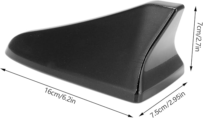

Thanks to the exacting measurements and advice in this thread, I was able to replace my missing cover as it probably flew off on some highway and landed on an unlucky someone's windshield.
This was the amazon item I bought and I think the model number may help if it ever disappears. 96219 or D5000EBQK
a lot of listings will say it won't work on the G80 (or 2015 Genesis Sedan in my case) with the panoramic sunroof maybe because they know you have to replace the whole structure, but since we're going the route of gluing anyway, as long as the cover fits dimensionally, we're good. Thanks to @joegr and @ted33021, we have that. (3.02" wide at the back and 5.93" long. It is 2.62" tall at the back) I've tripledchecked and measured with my calipers too. I think @joegr might have been referring to the base and @ted33021 gives a closer match with his pics of the actual cover.
So, I feel more important in any listing is a pic with the dimensions like the one:
I'd say the same goes for ebay, but I got mine on amazon due to "easy returns" in case it didn't fit. Originally, I thought based on the measurements, it would sit over the entire structure, but when it arrived, it ended up resting on the lip pretty properly. It was just missing a bit of the vertical curve that follows the roofline. Also, I suspect these guys may have measured the lengthwise curve too instead of just the straight line of length to get their 6.2 inches.
