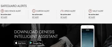

Congratulations on teaching your son to drive and appreciate a manual transmission. Does the Cdn connected app have geo fencing alerts, speed alerts and the other features of the US app?

That's a really good question! I had no idea that the connected app could do so much. Let me check. There doesn't seem to be that much information on there. I've attached a screenshot of what we get under the ''driving information''
