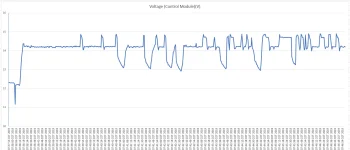

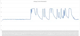

See these two graphs I captured. The first one looks bad and the second one looks good.
In both cases the voltage rises when decelerating, and lowers when accelerating.
Both look good. If the first one was falling under 12.0 I'd be concerned, although holding 12.2+ is considered acceptable. That graph shows 12.6 which is 100% charged voltage for the battery.
