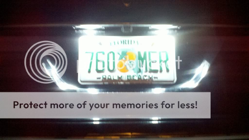

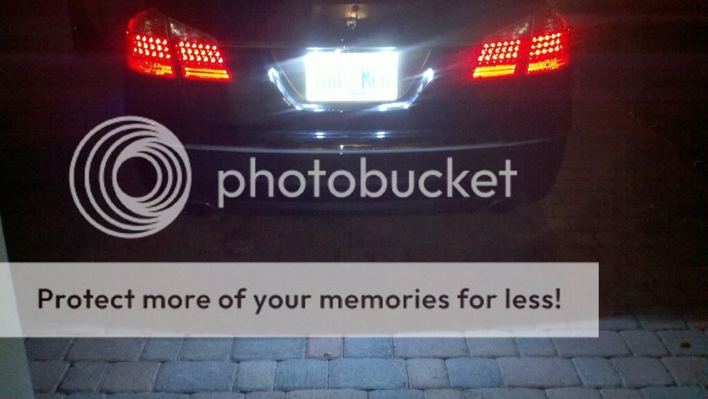

i have these installed http://www.v-leds.com/6K-WHITE-CANBUS-PROOF-p9594395-1-2.html they are extremely bright and havent had any problems with them so far.
sorry for the crappy pics...
