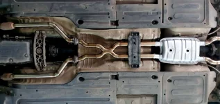

Wher did yoh get the catback iv been lookin everywhere. I have 2012 Hyundai Genesis sedan 3.8 v6
the "cat" in that previous post was for the 'cats' in photo.
But for exhaust Catback , I had it custom fabricated at exhaust shop (2" S.S. pipes, secondary cat deleted, X-Pipe, and kept oem mkd resonator with muffler ... you can see detail in my other post)
