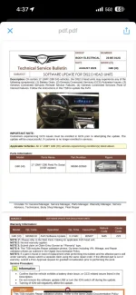

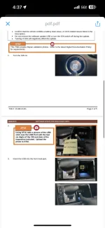

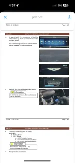

UPDATE. So here is the deal. I went to a local dealer last week and told them to perform TSB 23-BE-012G Software Update. They had no idea what that was and basically performed a regular navigation update that you download online and called it a day. I said whatever and I left, connected services still not working. Today i tried a different local dealer. Told them about TSB 23-BE-012G Software Update and they knew exactly what I was talking about. They told me since I'm out of warranty it will be 1 hour of labor so here its $185. I agreed. And guess what. My connected services are back up and running! I can finally remotely start the vehicle and the app updates, plus its finally showing good signal on the radio as it should not the red circle showing no signal. There are dealers out there that have no idea what or how to do this update, guess it depends. I went in, told them Genisis connected services told me to perform TSB 23-BE-012G Software Update and that's what they did, and I finally have connected services working, haven't worked since January. I wish everyone else good luck and that TSB seems to help a lot of people getting it to work. I've attached a picture of the TSB that the dealership printed out for me. @captain74 IMG_4404.webp

UPDATE. So here is the deal. I went to a local dealer last week and told them to perform TSB 23-BE-012G Software Update. They had no idea what that was and basically performed a regular navigation update that you download online and called it a day. I said whatever and I left, connected services still not working. Today i tried a different local dealer. Told them about TSB 23-BE-012G Software Update and they knew exactly what I was talking about. They told me since I'm out of warranty it will be 1 hour of labor so here its $185. I agreed. And guess what. My connected services are back up and running! I can finally remotely start the vehicle and the app updates, plus its finally showing good signal on the radio as it should not the red circle showing no signal. There are dealers out there that have no idea what or how to do this update, guess it depends. I went in, told them Genisis connected services told me to perform TSB 23-BE-012G Software Update and that's what they did, and I finally have connected services working, haven't worked since January. I wish everyone else good luck and that TSB seems to help a lot of people getting it to work. I've attached a picture of the TSB that the dealership printed out for me. @captain74 View attachment 55578

One important note. They said install failed after several tries and apologized that it's not gonna work. I asked them to copy the fix onto my USB. I left, inserted the USB and in a few minutes, system restarted and modem started working. The key thing is that when you insert USB, nothing comes on the screen. Just insert and wait for a few minutes. It restarts and starts working.

I had the same issue with one of my local dealers. When you plug in the USB it says there are no files on it, that doesn't matter. It's a reset, it doesn't have any files on it, you need to leave it plugged in for a couple minutes to do its thing. First dealer told me the same thing, that it kept failing. Went to another which already had performed that TSB on other g90s and voula, fixed. Mind blowing how they don't even read the TSB at some dealers; it clearly states on there to just leave it plugged in for a couple minutes.
