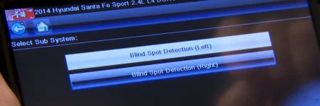

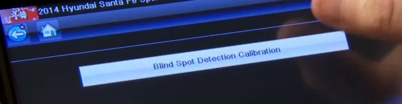

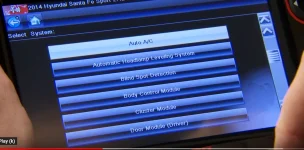

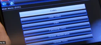

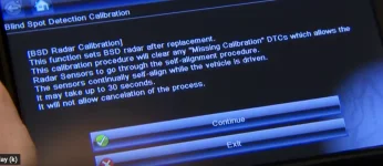

Thank you for the added details. I may go online and pay for the shop manual (I think you can get a one day download pass) and see what all is involved with the bumper skin removal. I may buy a clip tool while I'm at it as there are tons of them on the underside of the Genesis and even an oil change is a PITA with all of those clips.
Sort of expected the calibration to be a dealer trip with their proprietary approach to diagnostic tools. I don't think the engineering service screens can perform a system reset, but that might be something worth a look and I've seen the access sequence described here and elsewhere. I've also watched a YouTube from SnapOn with their diagnostic tool doing the re-calibration (it was a 2014 Santa Fe), so that may be another option. Interesting comment mentioned the finicky nature of the Hyundai BSD (read: sucks) and the fact that sometimes the re-calibration doesn't stick.
Here are some still pics from the above video showing the diagnostic/calibration screens for the BSD.
1821218213182141821518216
My friend had the snap on tool for this, that's the one he has used on other cars. Unfortunately it did not work, we even tried to fake it was a SantaFe, lol, which it could do, but it said that there was a security lockout so you couldn't fake it.
