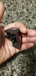

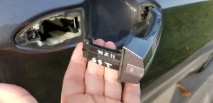

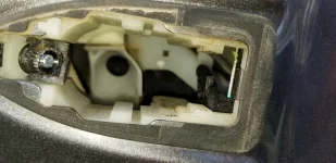

Right rear door handle cover just popped off today-broken plastic clip :(
The plastic around the threaded metal piece was broken into 4 pieces, so used jbweld plastic epoxy for that and gel for the base-going to grind the sides down and try the fitment.
Worked just fine after filing down the sides a bit with my dremel!
