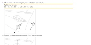

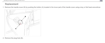

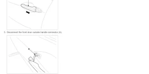

Any one know how to change them? The old ones broke at the screw which is supposed to hold them.
