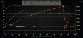

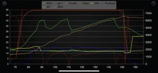

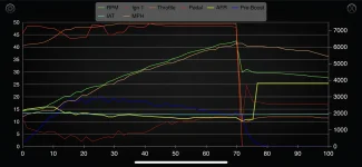

Too short for any issues to show up. You're not flooring it the whole way. Try a 20-80 run pedal to the floor.
Will do Chief.
20-85 map 2
25-85 map3
25-80 3rd gear map3
^Those logs look great to me.
How'd you get ahold of 94 octane?
In the first screen shot I see ignition drop to 0 in 3 spots suddenly. In the second screen shot it happens once. In the third, there are no drops.
Correct me here if I'm reading it wrong but that looks like a response to something like knock vs. it being a normal part of the ignition map?
Never mind... gear changes.
