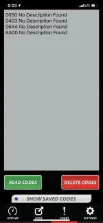

They're all going to be China connectors regardless who you buy from. Those of use that purchased the extension harness from the guy that specializes in it have not had any issues yet.Looks like is an issue with the 02 sensor harnesses I used may not not be the best. Going back to the positap and see if that solves the problem.
One of the codes 0050 is 02 sensor heater circuit open or shorted. I’m guessing open due to the China connectors I used to build the harness.
I think I will use the factory looking connectors to attach the fuel wire direct to the 02 sensor wire. Soldiered on and wrapped in the braided sleeving to blend in when disconnected
Yea I think there may be a bad pin on the ones I built. I’m going to use both wires on the above connectors to make sure there is s positive connection.They're all going to be China connectors regardless who you buy from. Those of use that purchased the extension harness from the guy that specializes in it have not had any issues yet.
