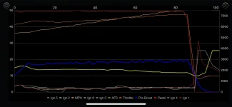

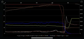

I did an experiment similar pull the fuel wires off on map 3 7th gear pull 70ish to 102 or so they look almost identical with or without the fuel wire
Wires off
Wires on
That is odd...Did you email JB4 support?
