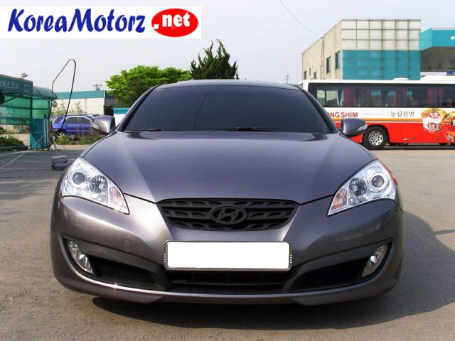

Take a look at this photo..(not mine). Look at the drivers side near the headlight. Now, look at the other head light. You will see a larger gap on the drivers side. EVERY Coupe I have seen has this large gap. On mine, it allows the hood to bounce up and down while drive. More than once, I have had to pull over to make sure the hood was latched. My concern, beyond it being an appearance issues is this, if the hood does not fit properly, it may not latch properly. My car has been in the shop 7 times for this and Hyundai has not been able to resolve the issue and has gone as far as to say it is normal.

If you do not see a gap anywhere on the hood, you are dang lucky. EVERY Coupe I have seen has the gap....even the ones in their commercial and advertisements.

I too in my OCD anal microscoping of the car once home noticed this glaring body panel feauxpaw annoyance. I'm glad I got on here today and saw this thread because I thought something may have happened during transit that they tried to smooth over before sticking it out on the lot. Anyway.......I made the big bumper on the passenger side higher where you can see 4 slots in the side of it when the hood is open and left the small one on the outside edge alone since that was level. Then set the big one on driver side lower where only 3 of the slots in the side of it were visible and on driver side adjusted the outer smaller one a bit higher until that edge of the hood was level with fender. This is where the most even gap is all the way accross and it tightened up the hood when closed in the latch eliminating any hood flop on the hwy. It is not perfect and would prefer both sides to sit flush like the passenger side did before adjusting but oh well. My final evaluation of the situation is that there is small amount of arch on the driver side front hood line where it passes over the headlight that doesn't exist on the passenger side. The passenger side seems flatter where the same part of the driver side has more of an arch. I see this as body panel imperfection from the factory, maybe just a good stretch of them since everyone doesn't have it based on posts here. I have mine as even as it can be and tight where hood doesn't flop. If others still have loose hood after evening out the bumpers then I'd suggest loosening the hoodlatch bolts and pushing down on the latch while retightening to lower the hood latch to pull hood tighter when closed. That's about all I got on this. Not gonna waste time on having the dealer come back with some lame normal nothing we can do about it bullshit. Short of replacing the hood with one without an arch or making their body shop flatten that portion of the front of the hood there is just nothing except more of my time and money that'll make any difference. I did get mine to an acceptable status to not involve the stealership in it but yes, the issue to begin with and the smoke up your ass the dealership wants to blow both suck but is about par and all you can expect nowadays.

It is the hydraulic hood lift arm. Pop it off and your hood is aligned properly. Hyundai is aware.
The hood, front fascia, and front fenders should be aligned together. Move one and another may need adjustment. A near perfect alignment of body panels can be done by a good body man with patience. I have restored several cars and am very anal about body panel gaps and alignment and I know it can take a lot of time to get it right.
