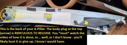

For any other DIY types like myself, here are some additional pics and tips to what is already here and were *instrumental* to my own successful FitCamX dual cam install today (no parking power line) on a 2024 GV70 - special thanks to everyone I quoted here (quotes have been trimmed for clarity - follow the links to see the full posts). This and the quotes might also help anyone with any brand of rear camera line to run.
YOU MUST WATCH THE FIRST QUOTED VIDEO TO UNDERSTAND YOUR A-PILLAR! I can almost guarantee you will break it or give up if you don't watch this video first. I know I would have. A gentle tug at the top of the a-pillar trim will *partially* release it. Then you will spend about 45 minutes wanting to smash it back in. Then it will nearly fall off into your hands - there is only 1 INSANE locked plug and 1 very basic simple one. Once the two plugs are released, a gentle wiggle UP will pop the pillar trim out of its socket. Installation is the reverse of removal - but the "insane" plug can be fairly easily just pressed back into place. You will hear a distinct thumping click when it seats. Tug to confirm. This single piece was by far the most difficult for my install.

THE FRONT MIRROR COVER - Pop the catches (gentle pry) at the two "bottom" corners (furthest from the headliner). Then SLIDE the assembly downwards to pop the top two catches. DO NOT PRY THE TOP CATCHES! The small piece behind the mirror mount will pop out. Install is reverse of removal - make sure those two top catches engage.

EDIT: One extra thing: The B-Pillar. I did NOT stuff it into the void here (no pics sorry) - I ended up FISHING it THROUGH the gap. So - remove the rubber trim on the front and rear doors, then you can FISH the line to bridge this pillar. There is a good sized void near the top of the trim, but fishing it it much easier as it is very tight at the seam.

Very well done tutorial. I used the drivers side which made it a cinch to run the harness for 12v power so my motion and shock detection work when car is off. That top clip on the A pillar was the impetus for a curse session, but got it after 10 mins of persistence. Same approach for getting rear cam wire to the back and mounted.
The point about keeping wires away from airbags is critical. This holds true not just for the A pillar, but also curtain airbags when running the wire for rear cam.
